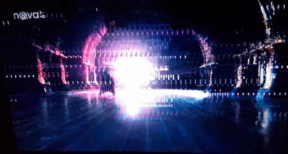

Could you please test one Live TV for longer time period ? For me 8.2.2.2 indeed fixed the short-time period Live TV playback. But after hour-two or so on one HD channel the video goes mad. FPS dropdown, decoding artefacts. If I switch the channel, it is good again for some time.

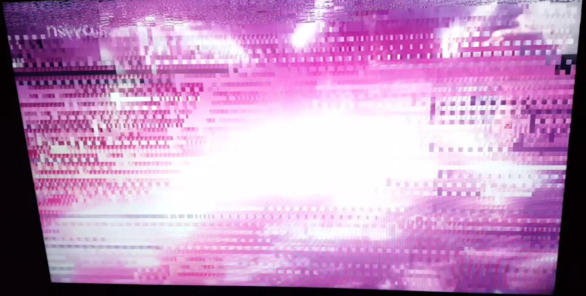

I have exactly same problem in the live tv, observed from 8.2.2.1, maybe it was present earlier, but not sure. But the 8.2.2.2 did not fixed it for me. In 8.2.2.1 it starts to stutter after some 10-30 minutes of channel playback. Yesterday we have watched a FHD movie with 8.2.2.2. After hour or so it started to stutter badly, fps dropdown, decoding artefacts, much worse than in 8.2.2.1, only later. Today I have checked the forum and this thread. Mine fallback frame option was disabled. Nothing interesting in the logs.

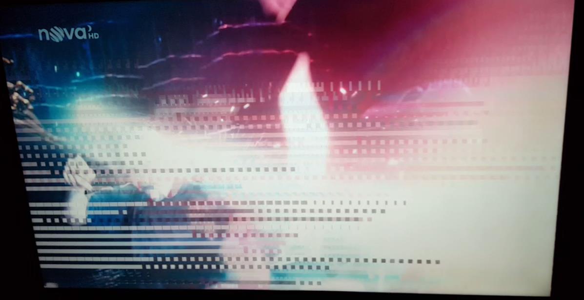

K1 Pro Combo, using DVB-S and T2 internal tuner for more than a year now. Introducing with 8.2.1.2 (not sure exactly) but greatly magnified with latest 8.2.2.1 I got frequent artefacts, stuttering, fps decrease in live TV. After reboot, the TV plays very nicely, but after hour or so, it became to behave badly more and more frequently, every some tens of seconds the FPS decrease to about 2-5 FPS, video stuttering also occurs. Every few seconds the frame disassembles itself to mosaic of artefacts.
If I record the stream and plays it on PC, it plays just fine.
