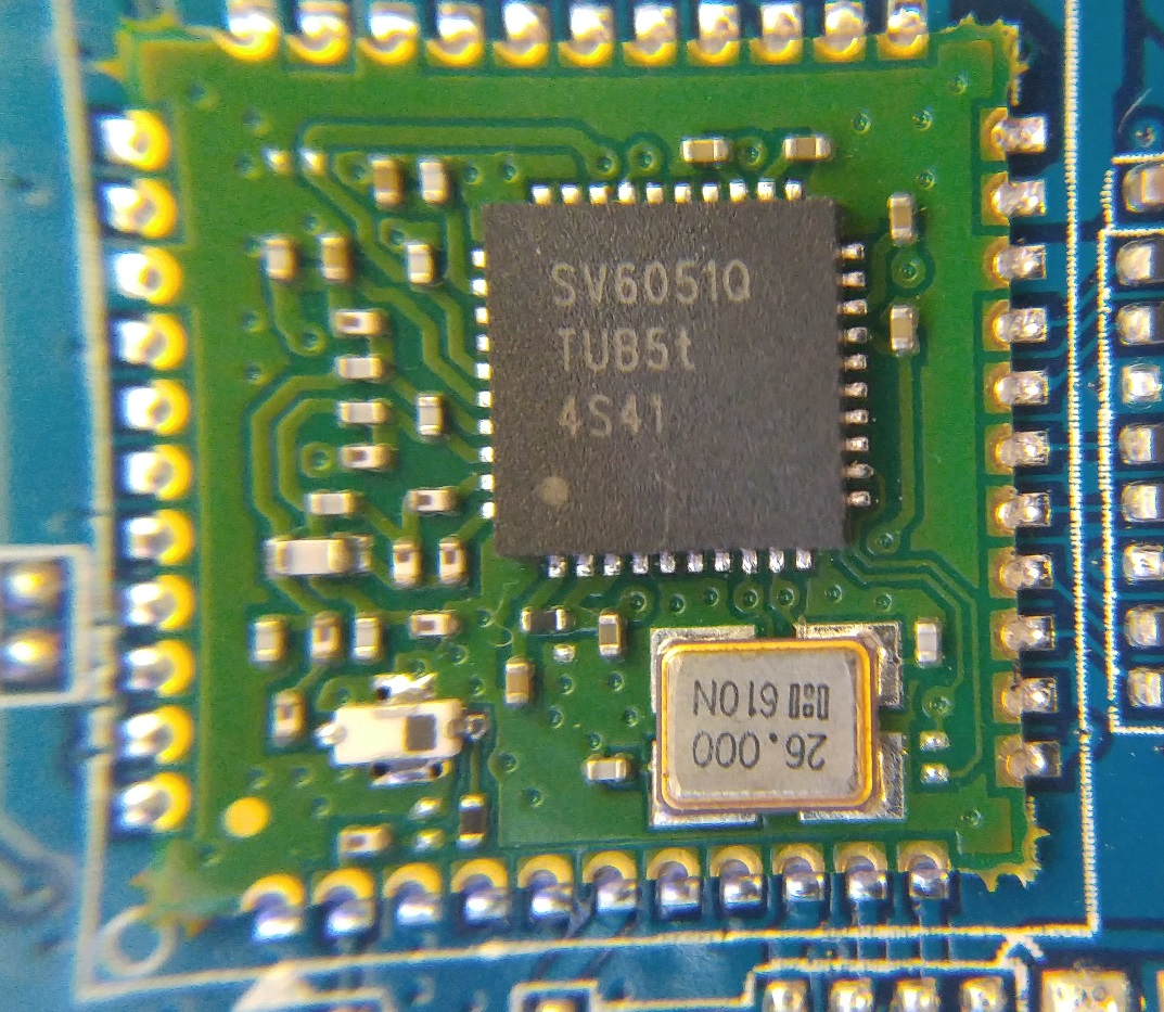

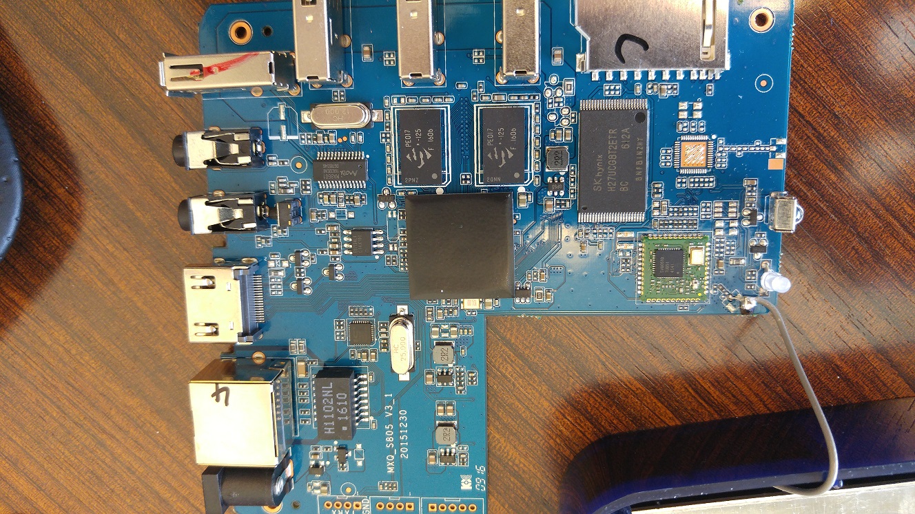

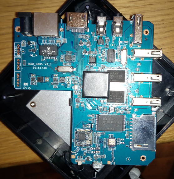

    Thank you for the logs. You seem to have an unknown SDIO WiFi chip that doesn't even show in the logs. Can you tell me what is the Realtek chip you have on your board? And can you also give me a result for cat /sys/bus/sdio/devices/*/device && cat /sys/bus/sdio/devices/*/vendor? I think you may have 8189FTV chip and there's no driver for it in my builds (yet).
    Ok here are some photos. Ill get the other files next...

    Ok cool I think I have what you need, I have added all the logs that were in the folder. I have "Blue" MXQ_S805_V3_1_20151230 and the box is currently running M201D SD 7.0.0.2 IMG. I do not see any wireless connection in the connections tab under LibreElec. Looking at my board my WiFi chip is labeled SV60510_TUB5T_4S41, eMMC chip SKhynix_H27UCG8T2ETR_BC_612A. Please let me know if you need anyhting else.
