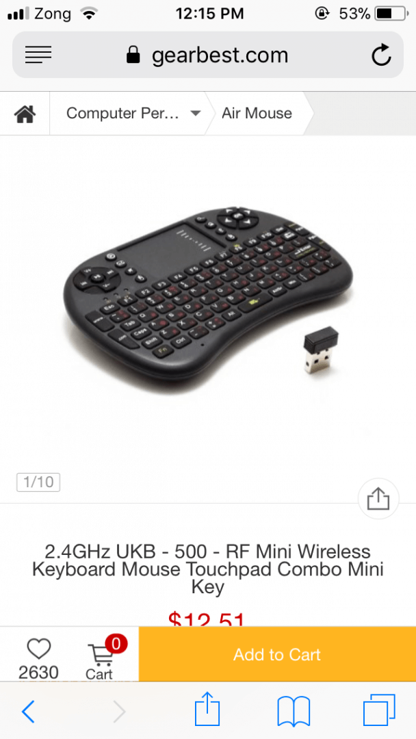

					Hello guys, I want help about latest build regarding (8.96.6) remote. If I use 2.4GHz UKB - 500 - RF Mini Wireless Keyboard Mouse In latest build 8.90.6 (just plug dongle into USB port and remote is ready to use) and remote is ready to use or also have to configure this remote just like default andriod box remote? I m also uploading the photo because I m going to purchase this wireless remote/keyboard, because I don’t have specific skills to add default nexbox’s infrared remote config file/follow the procedure. That’s why I m purchasing. Sorry for bad English. Any help appreciated, thanks in advance.
					Hello guys, I want help about latest build regarding remote. If I use 2.4GHz UKB - 500 - RF Mini Wireless Keyboard Mouse In latest build 8.90.6 (just plug dongle into USB port and remote is ready to use) and remote is ready to use or also have to configure this remote just like default andriod box remote? I m also uploading the photo because I m going to purchase this wireless remote/keyboard, because I don’t have specific skills to add default nexbox’s infrared remote config file/follow the procedure. That’s why I m purchasing wireless remote/keyboard.
