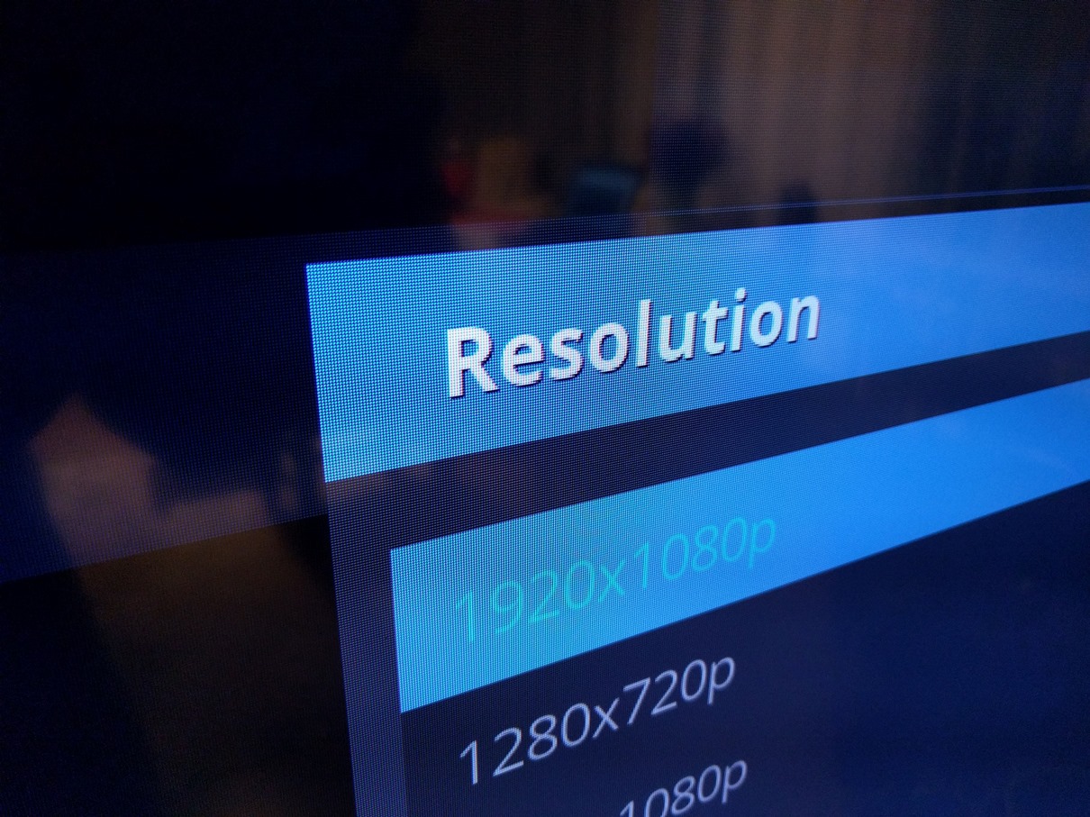

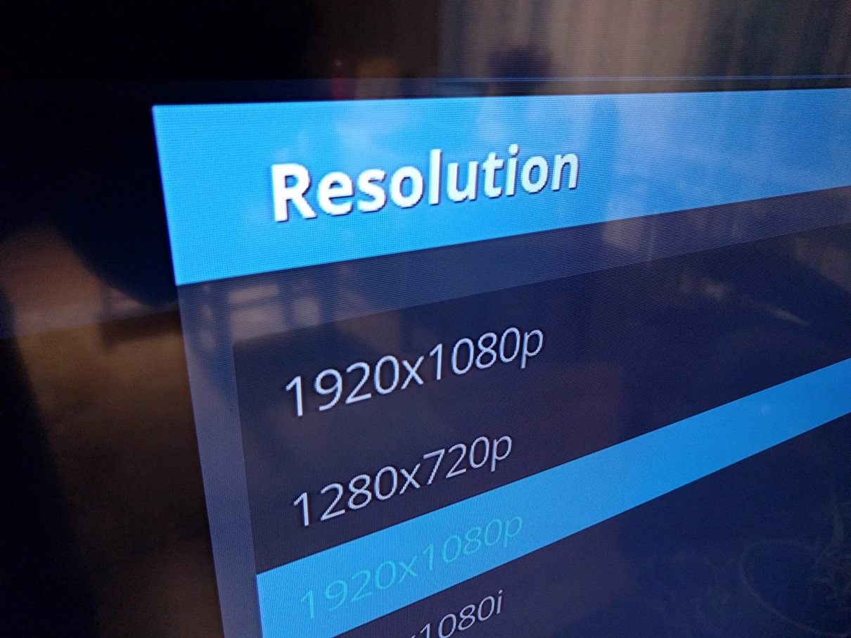

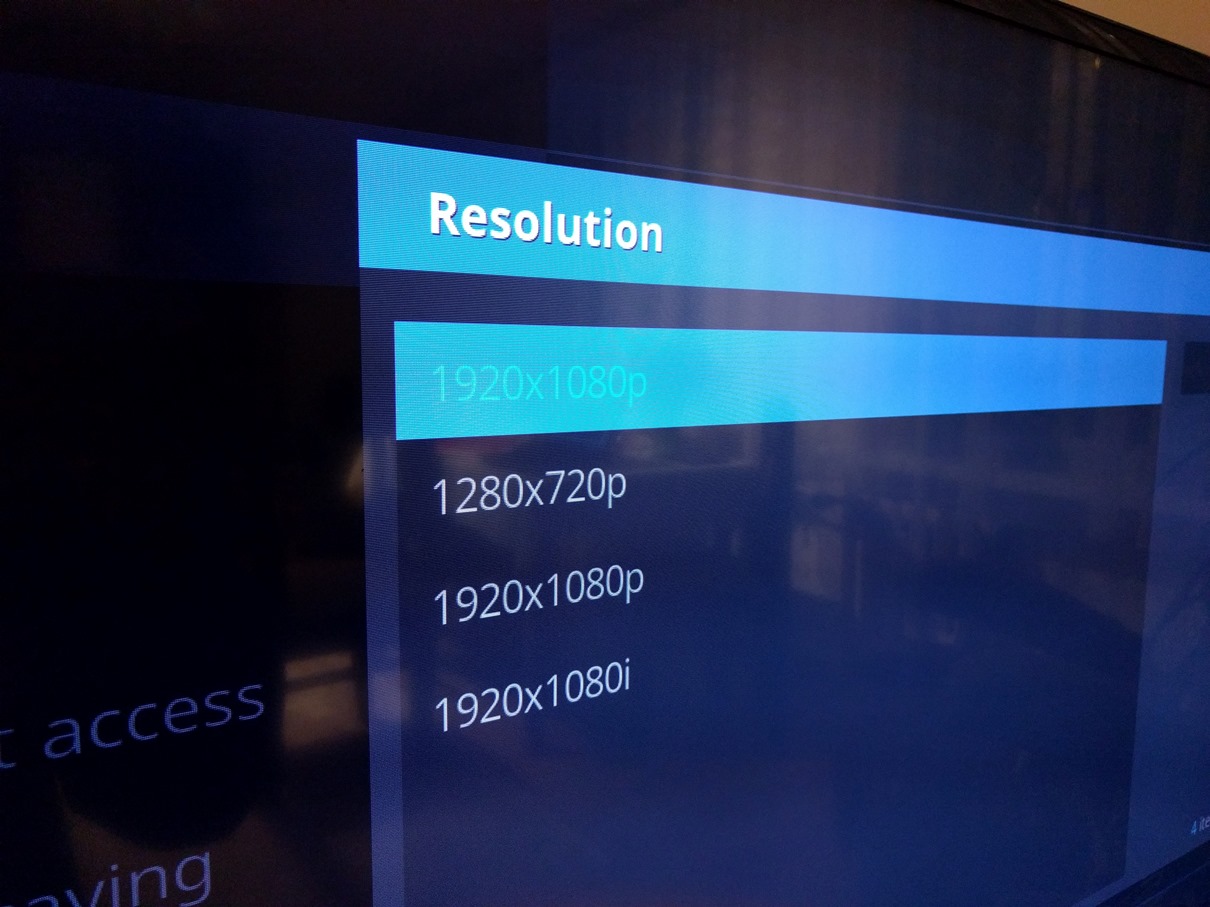

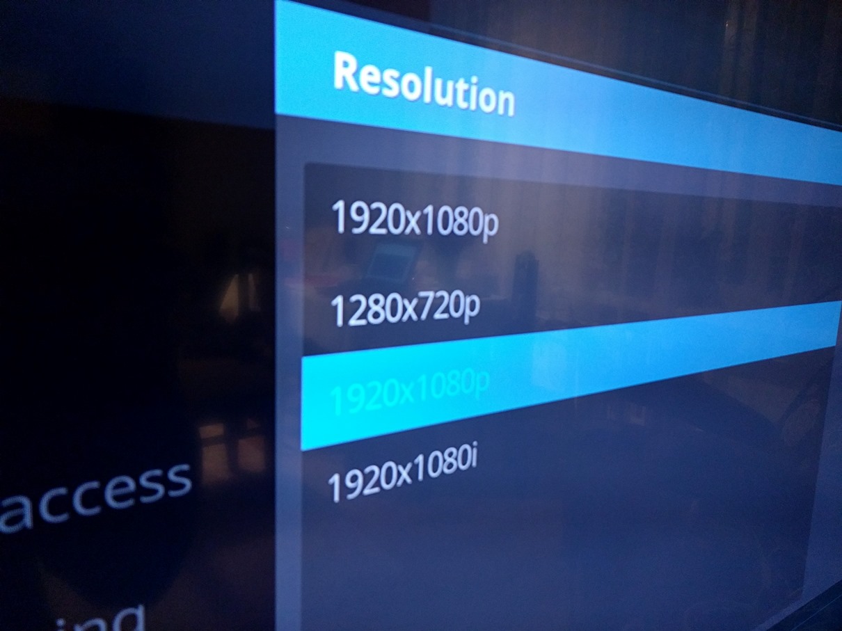

    1. Yellow ting during playback of the videos. What I've found is that the same behaviour is observed on the 009 build (someone there in the topic also was affected by this - no fix found). Here's a little pointer for you:
    Settings > System settings > Display > General > Resolution:
    • 1920x1080p - this is OK in the menu; white text/img is bright white - but for video playback white gets yellow tint, very annoying on the controls and subtitles and in the picture
    • 1280x720p - this has yellow tint everywhere (gui + video playback)
    • 1920x1080p - this has yellow tint everywhere (gui + video playback)
    • 1920x1080i - this has yellow tint everywhere (gui + video playback)
      So it looks like with the first setting is OK for GUI but then for playback it's switching to the other 1080 option (tv is not showing it's OSD with resolution info - so it was not changed).
      Please have a look at the pictures attached; I've taken them without any auto settings to get as much as close picture to what my eyes see.
      Actually on the pics it looks very close but in real life is yellow as dog piss on the fresh snow...
