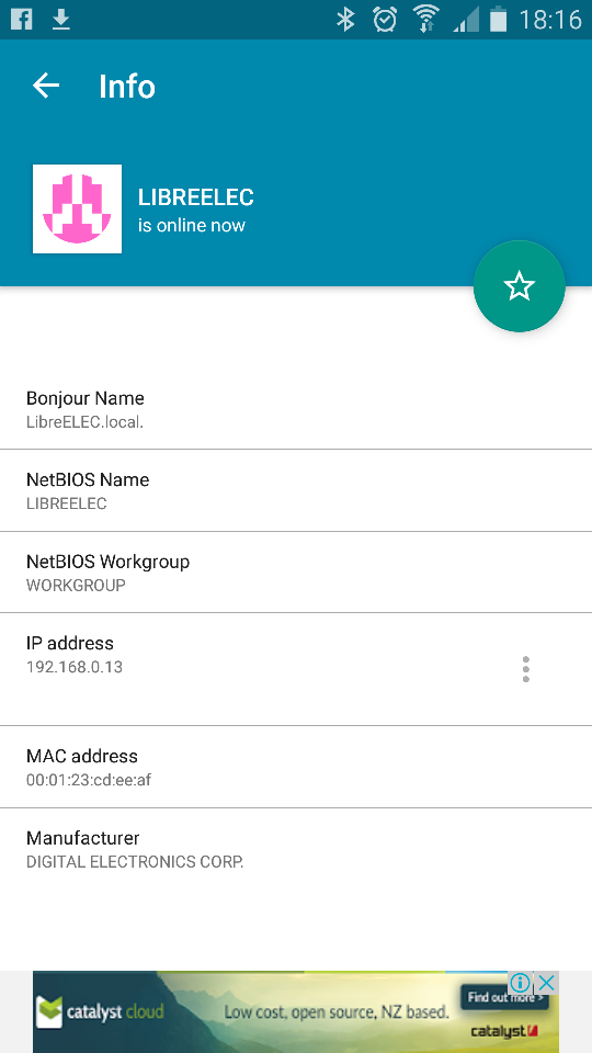

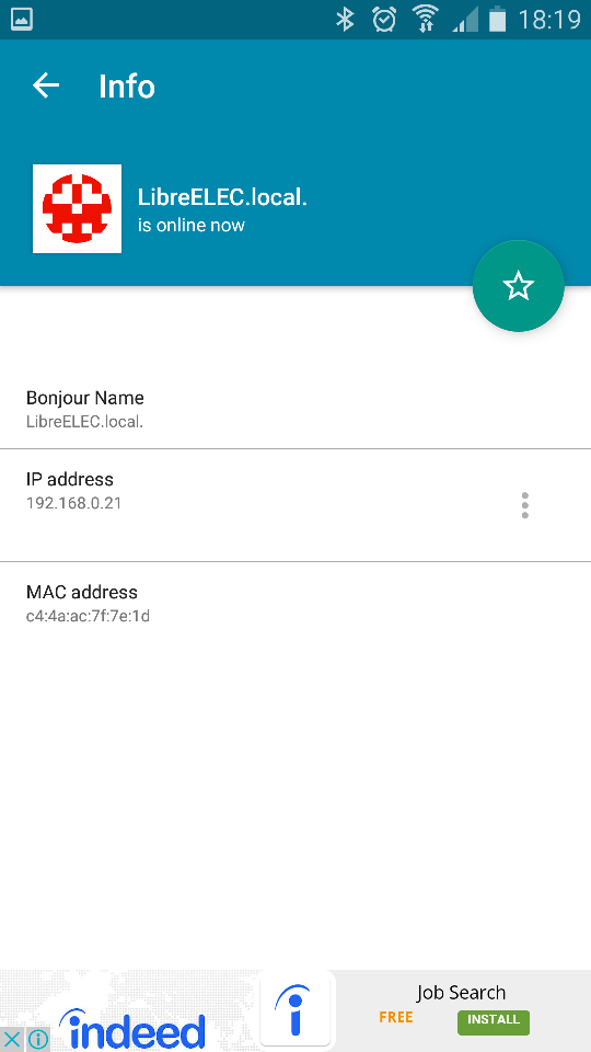

    Poida Can you test if this build reads a correct MAC for you: LibreELEC-S805.m201d.arm-7.0-devel-20160614205642-r23062-gbbc99e4.tar
    I've also added a small change that might make remote control wakeup work. Can you test it as well? I don't have access to the box right now and I'll be grateful for results.
    I too can confirm that this dev release also fixes mac address on my v3_1 device too [emoji3]
    Sent from my SM-G900F using Tapatalk
    Are both boxes the same motherboard version? If so, which version.
    For a lot of people, with only one box, that will be just fine. It seems to be causing issues if you have more than one on the same LAN (and even then, of course, only if they are both active at the same time)
    Can also confirm that the box does run fine and I have no problems with in connecting to Internet etc but I do only have one box I don't expect to have problems. I would expect in Android my mac address will be as it should be? Haven't booted to android to check that but I can do if required [emoji3]
    Can you reboot the box, grab log and post it here please?
    Probably you have SSV6051Q WiFi. Until I get a working driver source it's not going to work. Both box and chip manufacturer have not responded to my multiple e-mail requests.
    I too can confirm that the mac address is a generic one (00:01:23:cd:ee:af) on a v3_1 board
