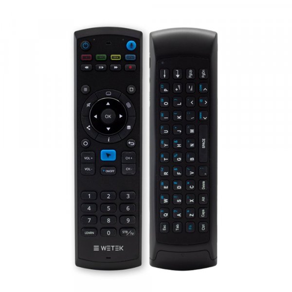

    I have a WeTek Pro Remote, and using this guide, created the following remote.conf:
    May look into swapping one of the buttons to open the search dialog box, but other then that, VERY SATISFIED! Cheers!
