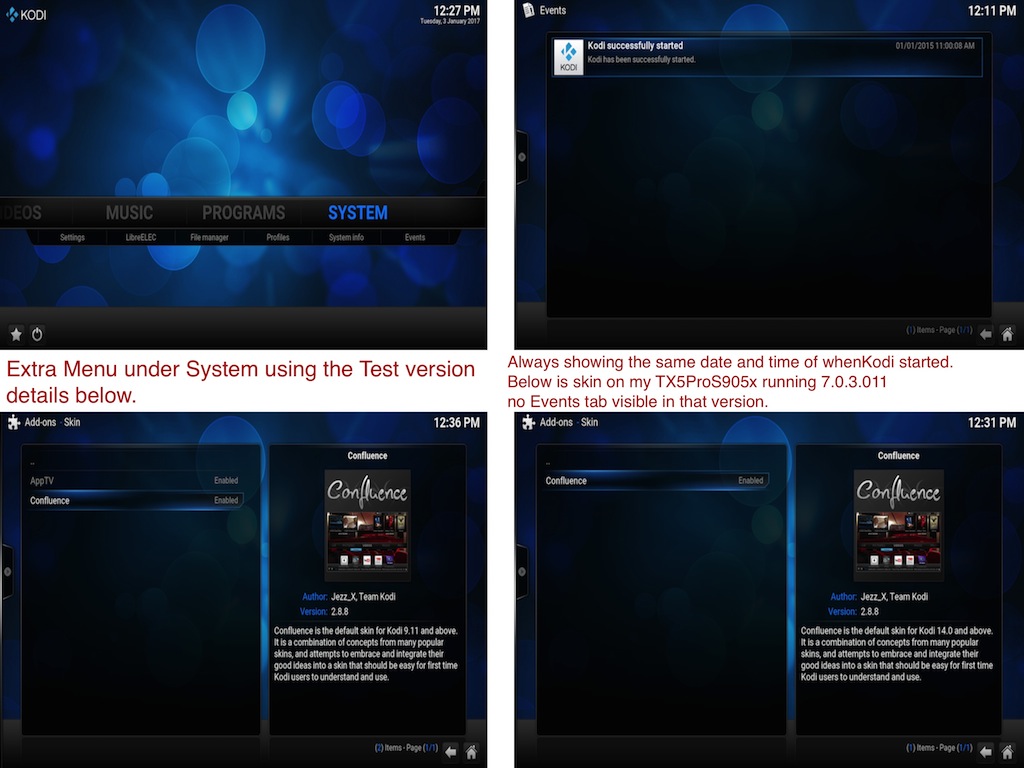

I have also picked something up with the Confluence skin now having a new sub-menu tab called Events.
I have no idea when this was introduced as i only just noticed it.
I have opened that tab menu and noticed it always reads that kodi successfully started with the same
Date 01/01/2015 11:00:13 AM.
UPDATE: To fix the Date to be read properly i went to LE Settings/Network and enabled Wait for network before starting Kodi 10 seconds.
This triggered my suspicion that we have a bug that may be caused by the guisettings.xml file getting corrupted - possibly the system being shut down during a write.
Or kodi thinking this file is corrupted, it fails to replace it with the default and hence a freeze.
