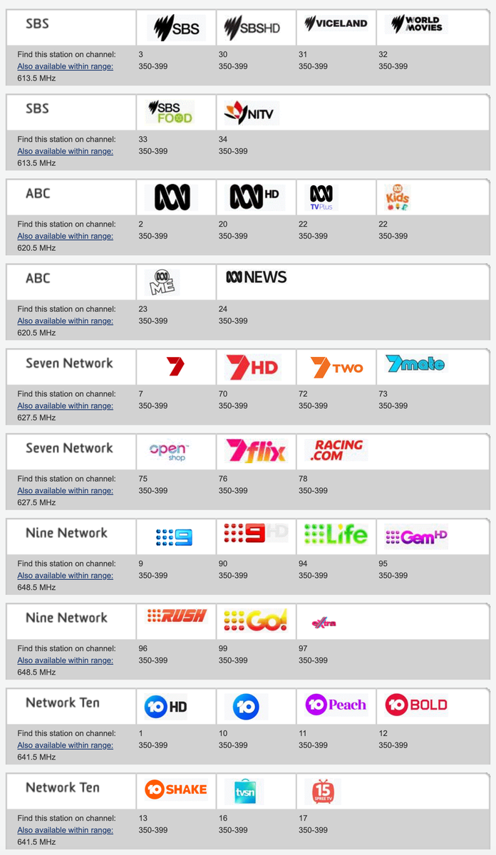

I'm actually on the Gold Coast, Australia.If you're in Aus - then enter your details here https://myswitch.digitalready.gov.au and you will get a couple of options on the left including "Channels for" and "More Coverage Information".
The first of these will give you a list of channels and the frequencies those muxes are on.
If you're happy to screen shot that list we can help ensure you have the right muxes set-up in TV Headend. The second will let you know the various transmitters that you could be receiving - but I expect the first choice of the website for your postcode is what you should expect to be receiving in most cases (and if your transmitters use Single Frequency Networks within the same area the frequencies may be the same anyway)
e.g. me just typing in Gold Coast QLD gives me these frequencies (dated 2016 - so it may be out of date - but equally stuff doesn't change hugely quickly in telly). Your post code may suggest a different transmitter which may be using different frequencies for your area. But here's what I got :
This shows that this Gold Coast transmitter, Mount Tamborine, is in a UHF area, with SBS's mux on 613.5MHz, ABC's on 620.5MHz, Seven's on 627.5MHz, Nine's on 648.5MHz, Ten's on 641.5MHz and (not on the screen shot) Prime's on 655.5MHz, NBN's on 662.5MHz and Southern Cross's on 669.5MHz.
If this is your transmitter - I don't think I see any of these frequencies in your TV Headend screen shot mux list - so that might explain why all of them fail to scan.
If you delete all the muxes in the list you have and manually add one - say ABC - you may find that scanning it will add the other multiplex frequencies automatically (it's an option in DVB-T to do that and it's done in the UK. When I add the BBC PSB1 SD mux in London, all the other DVB-T mux frequencies automatically appear. If not just add all the muxes manually.
I don't know that Mount Tamborine IS your Gold Coast transmitter - but hopefully this will give you a starting point.
I believe Australia uses 7MHz wide channels, DVB-T (not T2) with 8k carriers, 64QAM modulation, with FEC of 3/4 and GI of 1/16 suggested (though I don't know if all muxes use these settings) - though depending on your DibCom tuner driver you may find that you can leave a lot of these on Auto anyway - though 7MHz and DVB-T are likely to be needed to be explicitly set, and 8k is probably a given. (Some low power broadcasters may use 16QAM or QPSK rather than 64QAM - local TV in the UK uses QPSK for instance)
