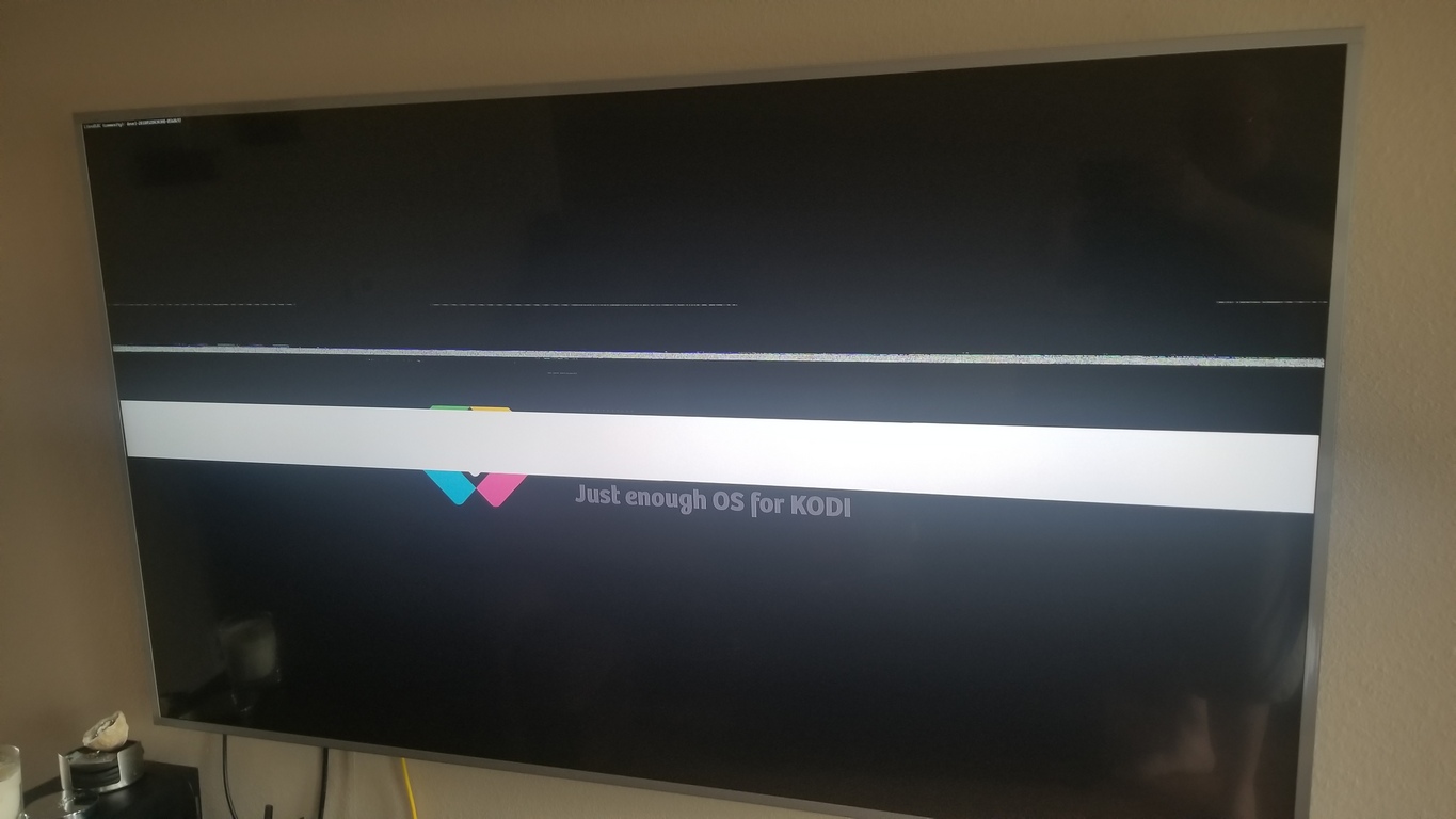

Still the same thing. installer is not responsive, has the exact same line through the screen as above. I reinstalled one of Millhouses test builds and copied the new file in the update folder. Boots to the same Librelec logo with the lines through it and reboots after 20 or 30 seconds.

Same thing for me still. The installer itslelf is still not functional. Still getting the lines through it and cannot select any options. Had to install another build 1st and off course xorg would not start but was able to drop the file in the update folder and reboot. It reads the file fine but hangs on the Libreelec screen still with the lines through it for 10 or 15 seconds and reboots.

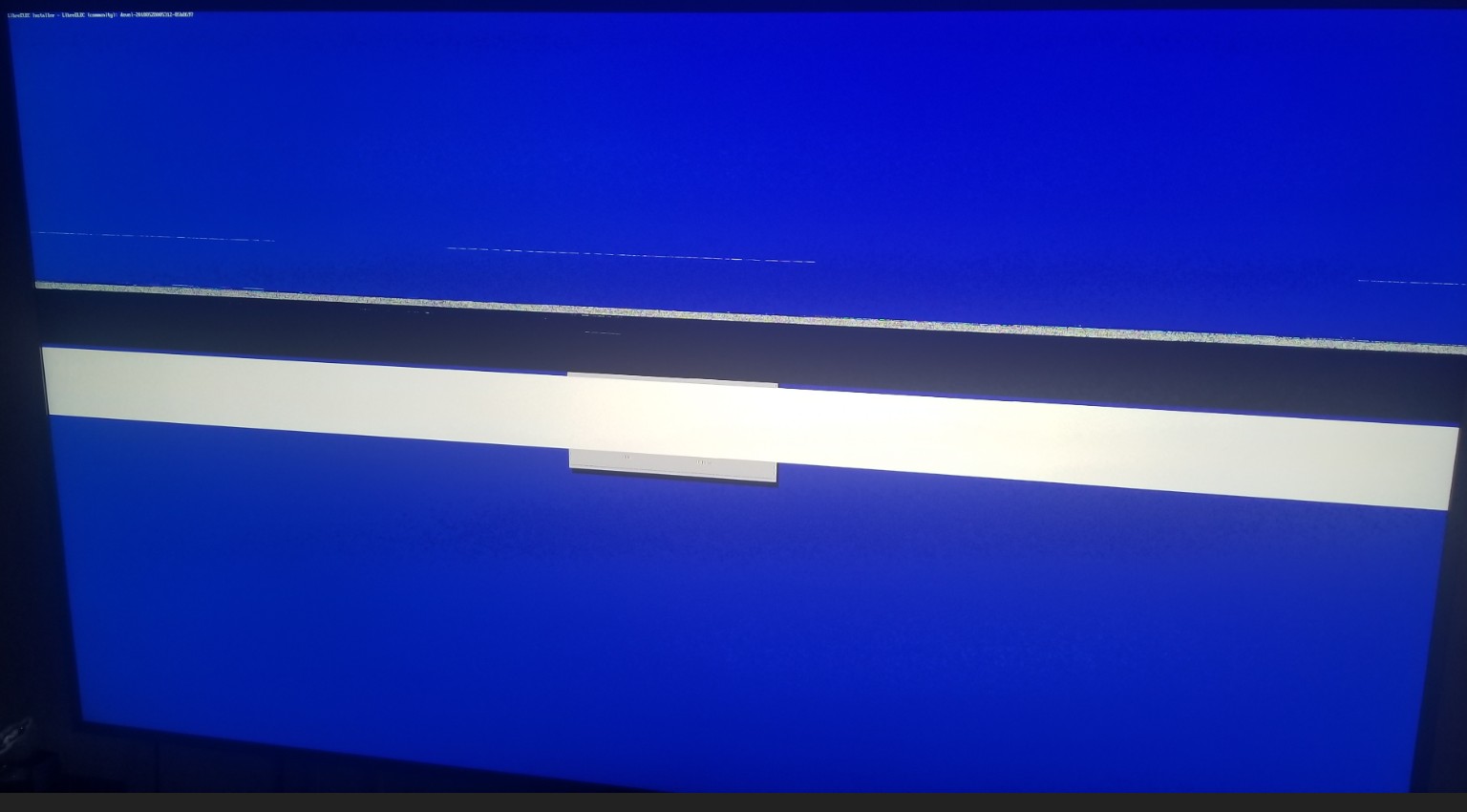

Thank you very much for your build, I am really excited to get this working, but having an issue installing. Getting this across my screen on install. I have downloaded multiple times and used a few usb sticks.
I also tried to install another version of LE and dumped the file in the update folder, but when I restarted I got the same line across the Libreelec startup screen, then the system reboots. I am using a ryzen 2400G on an asus b350m-e. Any ideas? I currently have both Windows 10 and Ubuntu 18.04 installed. I am also going through a Denon X2300w to a Vizio P65-C1
