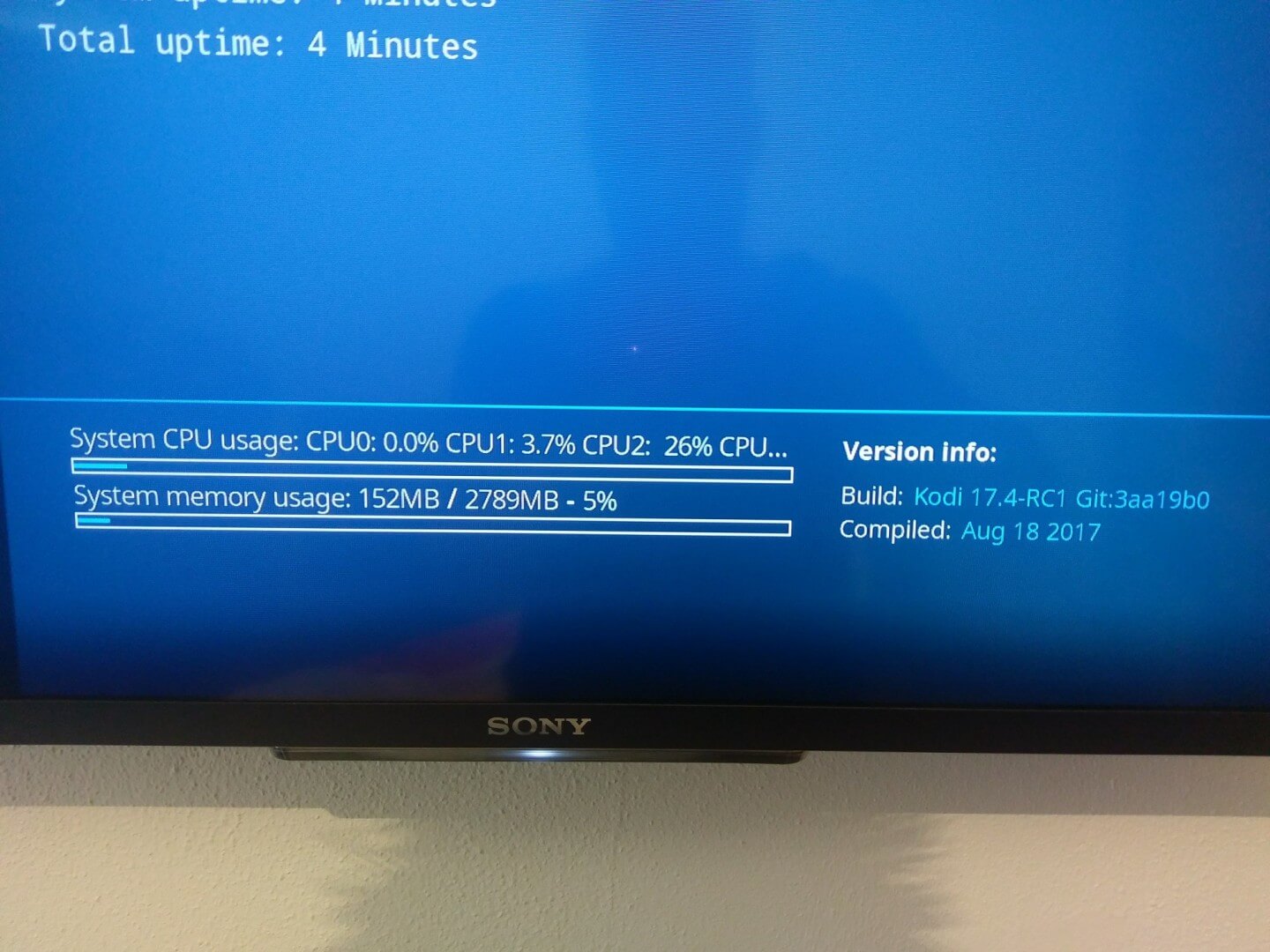

    How can I see in LE if it's really 3g? Because apparently S905X is maximum 2g right?
    EDIT2:
    According LE it's also 3g, see the attachment:
    Fietspomp The DTB you attached contains device trees only for 1GB and 2GB RAM. I guess you have only 2GB of RAM. It also has some unknown (to me) boards: gxl_p211 and gxl_p215. Can you tell me which device tree is used by your box? You can check it running this command in Terminal Emulator in Android: cat /proc/device-tree/amlogic-dt-id
