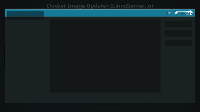

    Back from a trip I see your message, I tested and it looks like the add-on updated to V.1.04
    But I open the configuration page and see the same crippled picture as before!
    Maybe a fresh install would do it, but this is not possible because the other linuxseerver.io addons require it and so can not be deactivated/deleted etc....
    Any idea ?

    3. While checking the images at .../.kodi/userdata/addon_data/service.system.docker/docker/.... I found a lot of old (orphaned?) images/overlays. But I read that the updater has now a prune-function. When I check in the LE gui and open at the updater add-on the configuration page I see no entries on a blank screen with a crippled header?? What goes wrong here, what to do ?

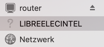

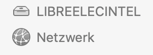

    Hi,
    since a few days I have in macOS finder no symbol anymore for the Libreelec computer in the network, finder is showing a question mark instead of any type of computer icon (see screen shot). Anybody has an idea where that comes from?
    How does it work with avahi in Libreelec? I have enabled it and see at /etc/avahi the usual files in the read-only filesystem, but only the ssh service is announced via avahi/bonjour....?
