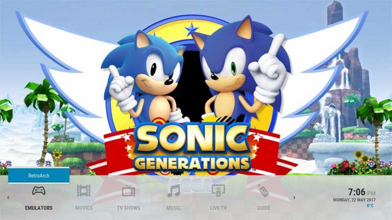

Has anyone looked at adding the "Emulators" menu item to the Confluence skin that can be retrofitted on Kodi 17?I'm not a big fan of Estuary and have switched most of my LibreELEC V8 systems back to Confluence - but I can't see how to use Confluence to launch EmulationStation on the Community build.
(I'm on a generic x86_64 build)Thanks.
You can add it via a custom menu command anyway with almost all skins.
Think Aeon Nox's menu where you add menu items to the menu with custom commandsAdd another menu item called Emulators = XBMC.System.Exec(/usr/bin/emulationstation.sh)
Then add a submenu under Emulators called RetroArch with custom command = XBMC.System.Exec(/usr/bin/retroarch.start)
this way you can access retroarch easier -
