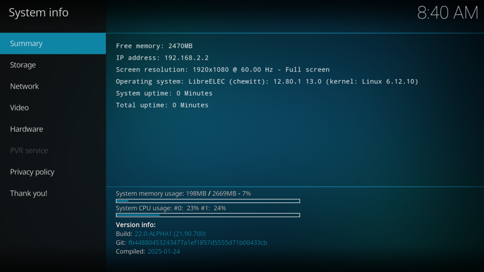

LibreELEC-Nouveau-Legacy.x86_64-12.80.1.tar 261 MiB 1/27/2025, 10:57:09 AM Kodi appears: no difference.
LibreELEC-Nouveau.x86_64-12.80.1.tar 258 MiB 1/27/2025, 10:57:02 AM EDIT
pastekodi: https://paste.libreelec.tv/suitable-yeti.log
modetest | paste: https://paste.libreelec.tv/lenient-sailfish.log -
LibreELEC-Nouveau.x86_64-12.80.1.img.gz 258 MiB 1/25/2025, 3:18:26 AM With Geforce 9400GT, pastekodi: https://paste.libreelec.tv/flexible-joey.log
LibreELEC-Nouveau-Legacy.x86_64-12.80.1.tar 261 MiB 1/25/2025, 3:18:00 AM With Geforce 9400GT, pastekodi: https://paste.libreelec.tv/guiding-crawdad.log
The Nouveau-Legacy (x11) works! After the black screen with pointer Kodi appears. I have added the addon Retrospect: it can be found in the log.
Remark: The cpu usage is four times higher than Kodi running under Slackware when idle.
