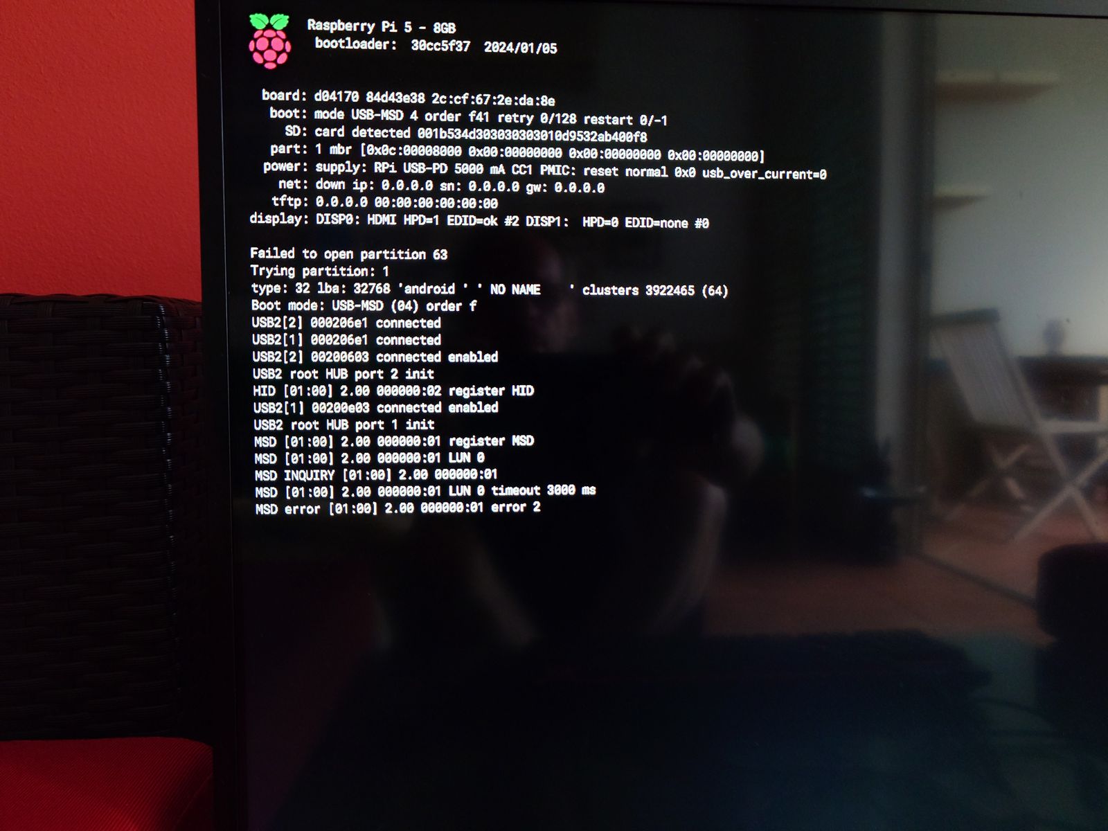

    I do not have access to a machine with an SD card slot other than the raspberry pi itself. So, I want to create a USB stick from which I want to boot the pi and then I want libreelec to install to the SD card. I _think_ this is possible...
    I've gotten the USB stick written, no problem. Then I boot the pi with the stick and the SD card inserted, but when libreelec starts, I do not see any options and it just resizes the file system on the stick. There's got to be an easy way to get to some kind of install-from-live-USB, but I have looked through the forums and have found nothing.
    I see this step:
    After this it libreelec just starts and then resizes the file system, at that point - I think - I'm too far, right?
