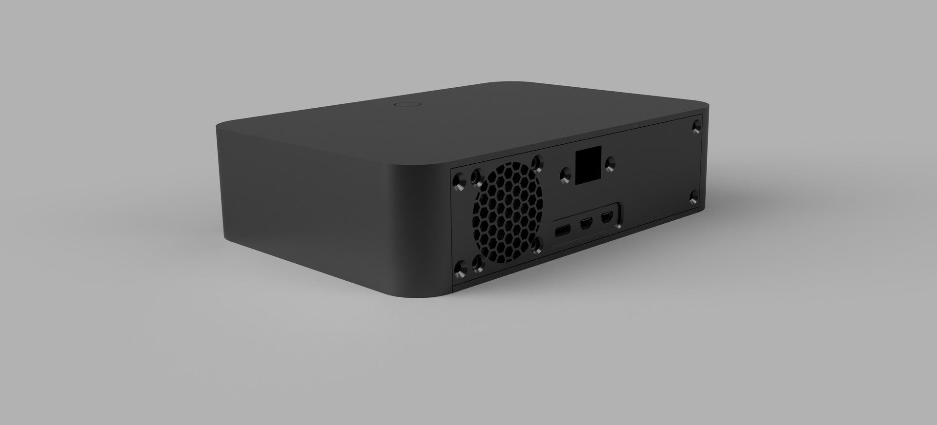

Ended up going the Pi5 route. Arrived today and seems to be working ok (passthrough audio to receiver, HDR10 video etc.)
The 3D-printed case design is coming along nicely too.
