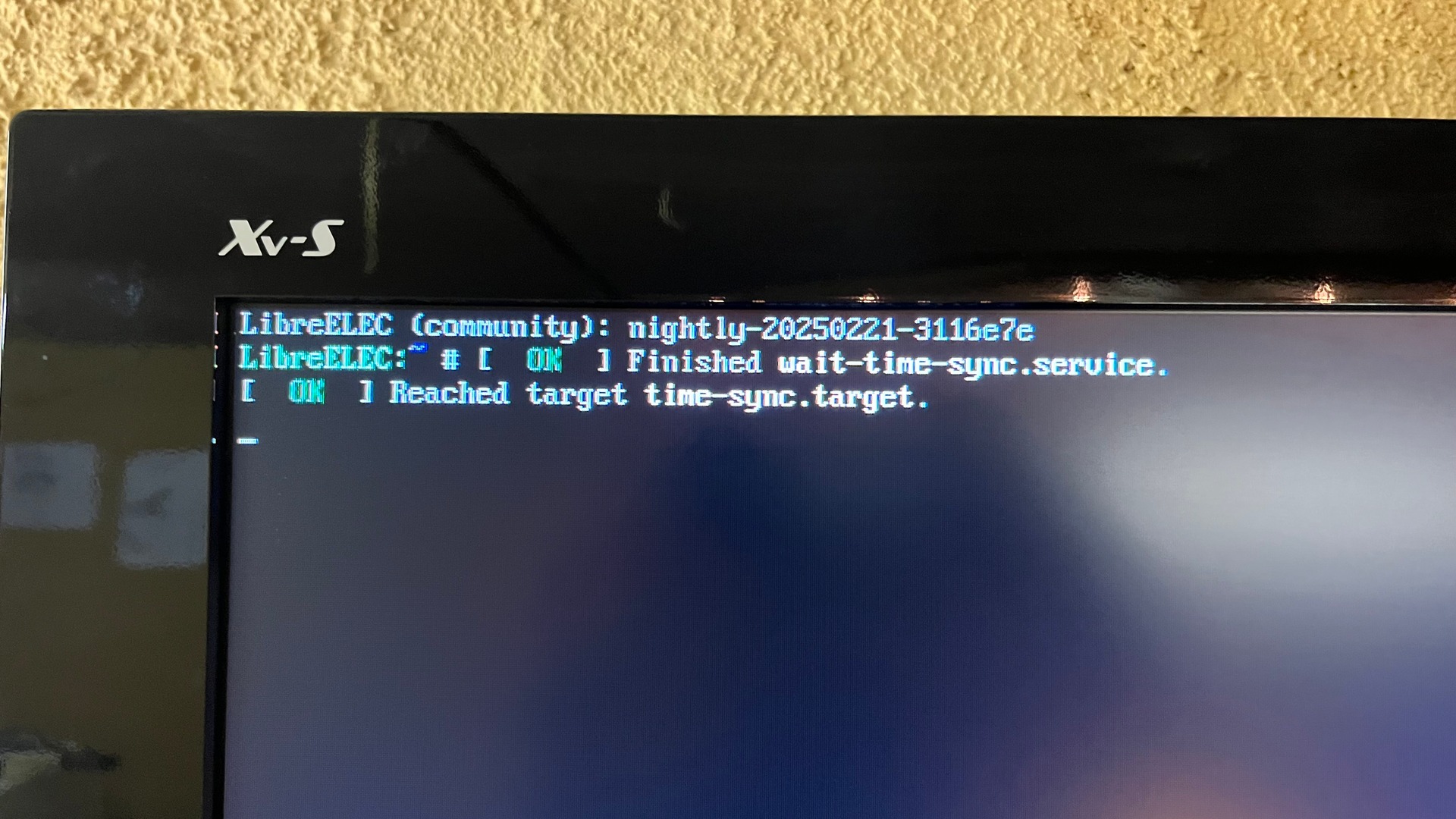

    Hi,
    after successfully installing newest LE13 nightly on my HP T630 i also wanted to install it in my cellar on HP T620.
    Boot screen hangs but system seems to run in background.
    Can not connect via SSH.
    But i can browse the diretories with a Windows Client.
    Installing LE12 does not have this problem
    ZIP-File attached for LE13 and LE12 after install and reboot
    I am a windows guy and have not much knowledge with linux ...
    Any help appreciated ...
    EDIT :
    I removed "quiet" and added "textmode" to the RUN-command on the USB-stick (found in other thread)
    The result you can see on the screen-photo attached
