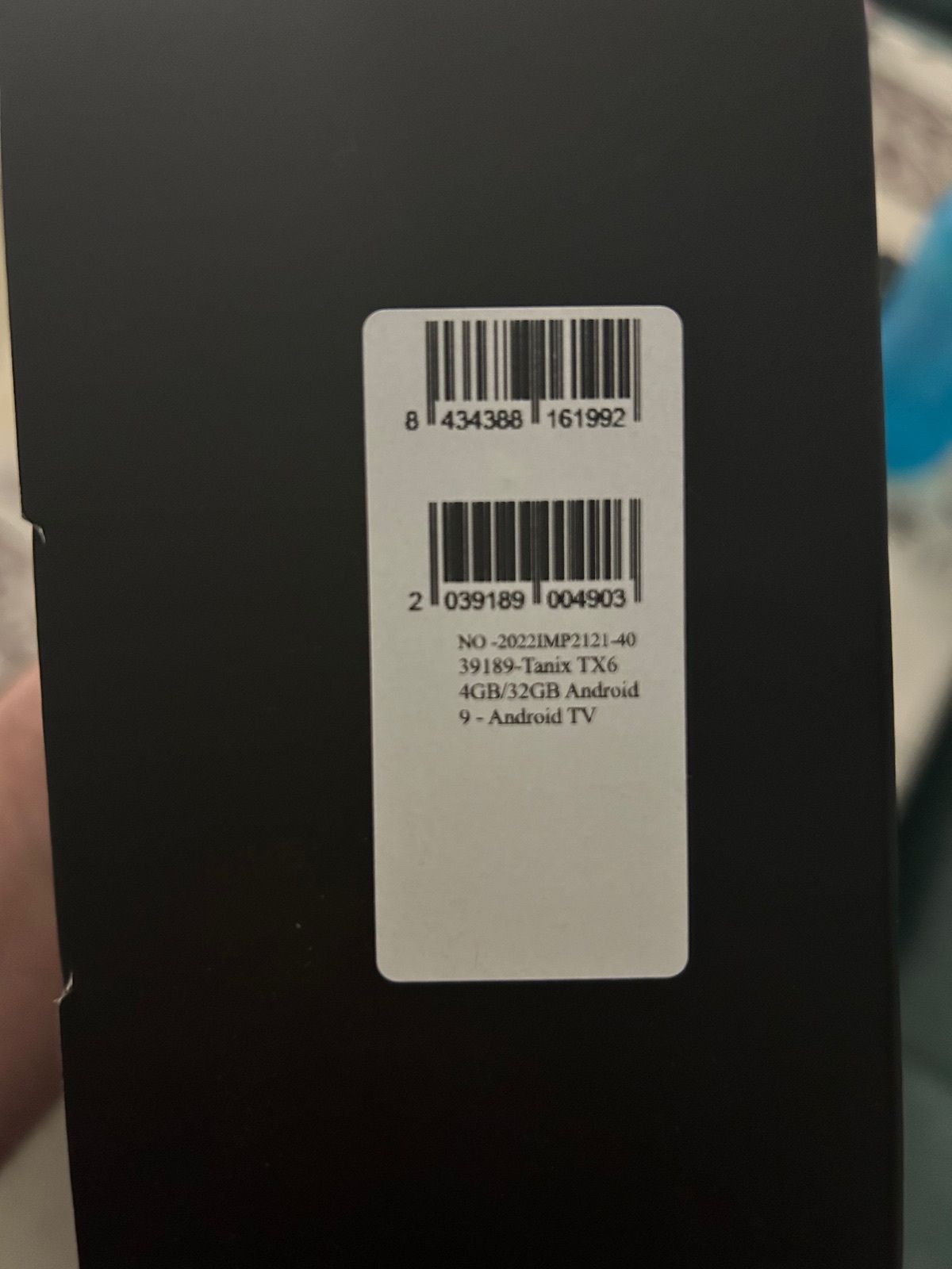

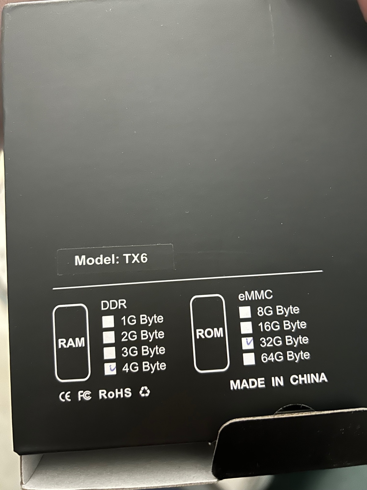

Yes, its TANIX TX6. I attach pictures of the equipment
