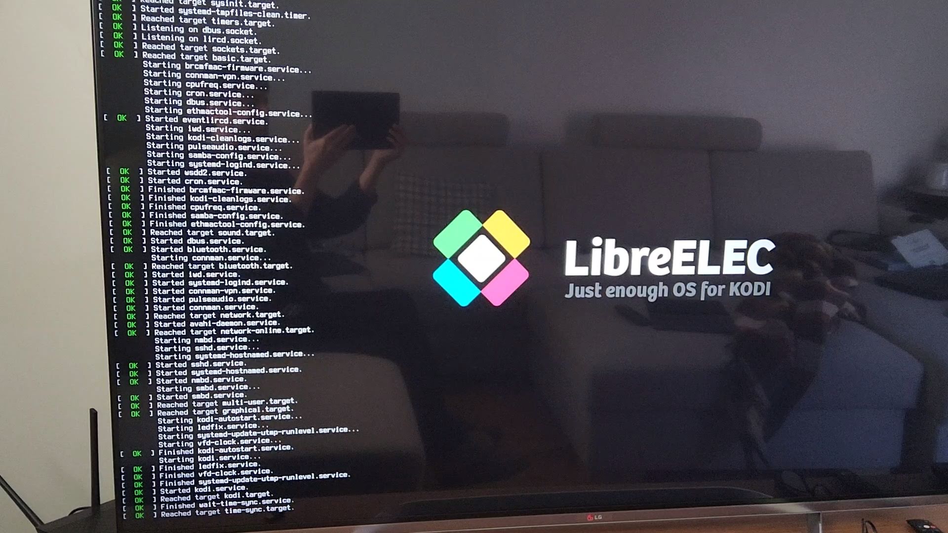

I downloaded the LibreELEC-AMLGX.arm-10.95.0-box.img.gz and used the LibreELEC USB-SD Creator to write it to an micro sd card. I updated the uEnv.ini to the correct neo dtb.

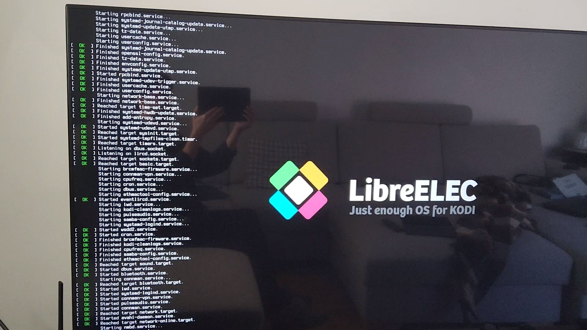

When i start the box with "6 sec button method" than the Libreelec started to boot and the partitioning went well. After the restart i see the Libreelec logo for ca 20sec. After the Libreelec logo disappeared i see only a black screen, or the Kodi "load" screen.(I have not seen any screen like "Starting kodi the first time"). I restarted the device sometimes and always ended up with black screen or kodi load screen.
To be sure that i did everything well i re-flashed the SD again, made the uEnv.ini changes and started to boot again.
I left the box for 2 hours, and i still see the kodi loading screen so i guess it is frozen.
On the box itself i am using the following: FW001 Android 7.1.2 20191120 [Community Edition Nougat Firmware] (https://theminixforum.com/index.php?thre…-firmware.2107/)
Could you please help me with that? Should i flash the original FW to the box? Do you need any log files?(I guess i can see them if i take out the sdcard and read it on my PC).
