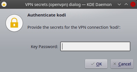

    The key password is the password you used when you created your ovpn user key on the server..you will need that to connect otherwise anyone with the ovpn file can connect to your server..
    I managed to figure that out, but trying to set this up at home on a single network was futile. Thanks though!

    Will I be able to test this connection even though server and client are on the same network behind my router's firewall? I did try to connect already by importing the ovpn file into my kde network manager, but it's asking for a "Key Password". Obviously I have something wrong as I understood that it should not require a p/w at all.
