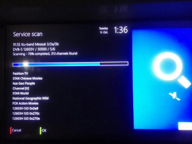

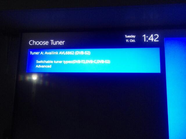

    i tested vitmod v2 rc6 with k2pro.dtb and replace rc6 enigma2 folder usr/lib/enigma2 with rc5 enigma2. the broken gui fixed. dvbs2 working well. i attached here some pictures. i use LAN Nework for internet.
