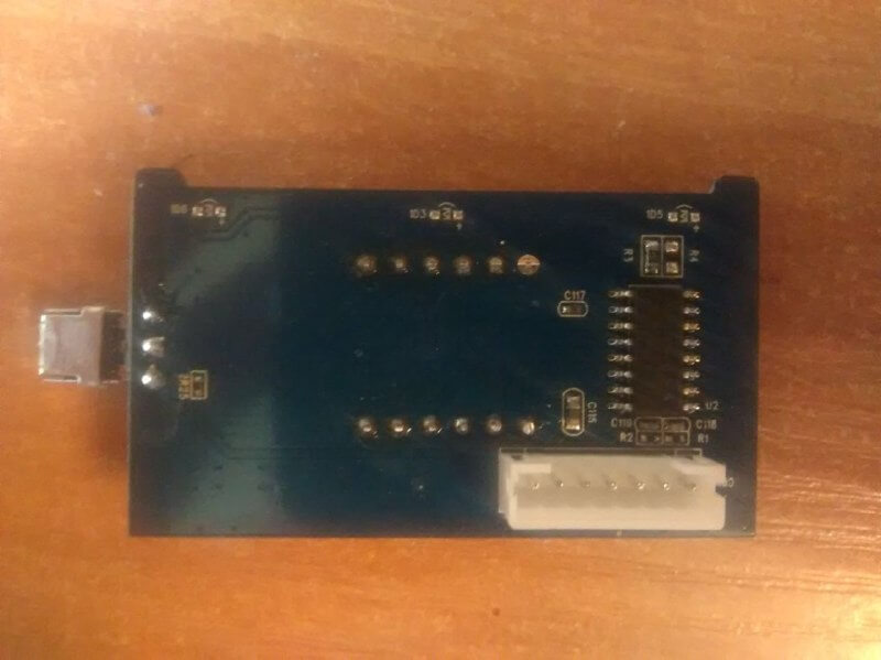

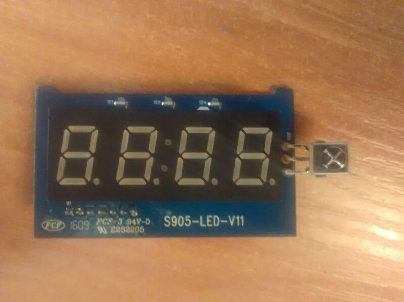

I have the MXV + S905. Installed Libreelec 8.90.5 clock on the console did not work.
1. MXV+ S905
2. Amlogic_s905/dtb_file/S905/MXV+ at master · 150balbes/Amlogic_s905 · GitHub
3. gxbb_p200_1G_1Gbit_RealtekWiFi
4. FD650B-S 005CYL0002
