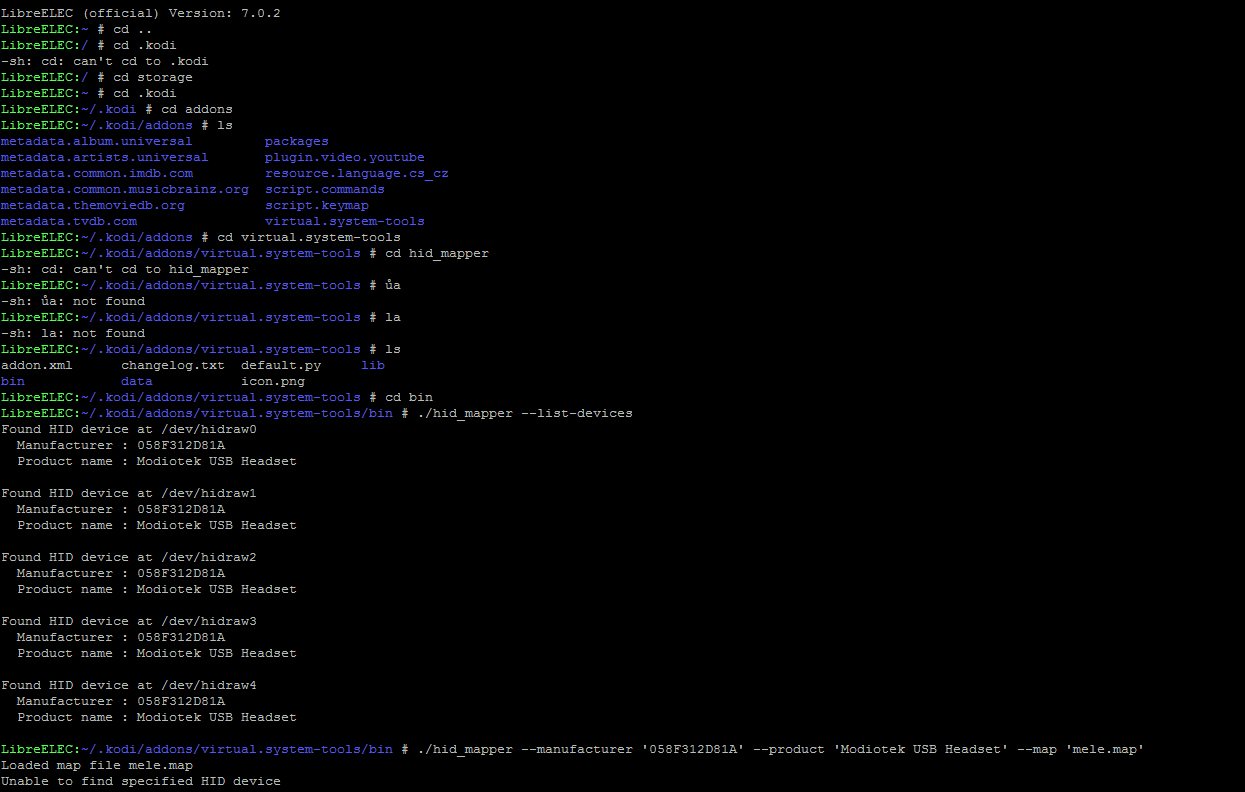

Hi! Complete newbie on linux here...
I've been using KODI on windows with MELE F10 Pro for years and now that I need to run Kodi off of RPi3 it does not work properly.
Apart from the AirMouse not working, there are keys that are not recognized by LibreElec that I'm used to and now they don't work.
( Mele F10-Pro 2.4GHz Remote Control Air Mouse w/ Keyboard - Black - Free Shipping - DealExtreme )I've tried to use system-tools addon which has HID_Mapper in it, but while it recognizes the HID device, it won't enter the learning mode and does not recognize the HID device if I build the map file myself...
HID_Mapper: [LINUX] Generic HID Remote Driver for XBMC (Drivers for XBMC on Linux and XBMC Live)The HID Mapper shows the device, and as opposed to the how-to, I didn't disable the remote in Xorg conf.file as I didn't find it. I presume LibreElec uses another service/daemon to manage HIDs that would need the remote disabled? But I have no idea what it is and if so, how to disable it...
I've attached screen from Putty, this is what I get.I know the scan codes of the remote from a colleague of mine who found out somehow in linux:
SMART ASSISTANT: 02 4B 03 02 00 00
PICK-UP: 02 49 03 02 00 00
HANG-UP: 02 4A 03 02 00 00
SOUND SWITCH: 02 48 03 03 00 00Can anyone help me? As I am a complete newbie in Linux/LibreElec, I'd need a little more help than your average Linux user...
Just to be clear, I'd like to somehow make the four buttons work and let the rest be as they are, but if I'll end up re-mapping every key, I'd be OK with that.Thank you!
