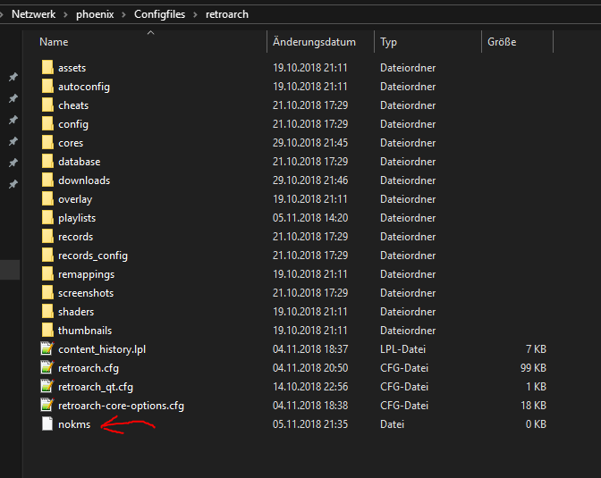

    create an empty file called nokms in /storage/.config/retroarch looks like AMD cards don't like KMS
    Maybe another option could be to create a file called radeon-kms.conf in /storage/.config/modprobe.d which contains this line:
    options radeon modeset=1
    I can't test it but this file is used at debian systems to tell the kernel to use kms for the radeon module. I haven't checked how LE handles this & I can't test it myself but maybe this is needed for LE too.
    If you create radeon-kms.conf delete the nokms file to test if kms finally works.
    Hi. First of all, thank you for your time, I tell you that it was solved.
    1. Create the file radeon-kms.conf in /storage/.config/modprobe.d that contains the line:
    options radeon modeset = 1
    And get the same result.
    2.- Create the file nokms in /storage/.config/retroarch
    And then yes, RA opened without problem.
    I thank you very much for your help mate. Greetings.
