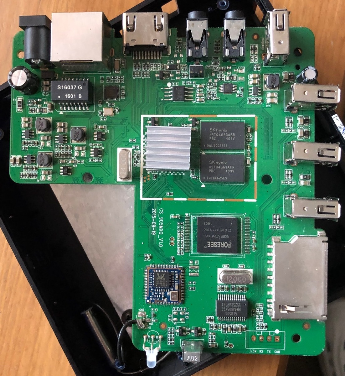

    I'm not sure how I never found the device tree link you have supplied in my previous searches. As far as the model is concerned I did try to find my original purchase info but no joy. That was my reason for referring to my box as MXQPRO (not 4k). Here is a photo of the pcb.
    The SK Hynix H5TQ4G63AFR identifies as 4Gb DDR3 SDRAM
    The Foresee NCEFAT28-08G identifies as 8Gb eMMC, although apparently it's an eMMC controller with NAND Flash.
