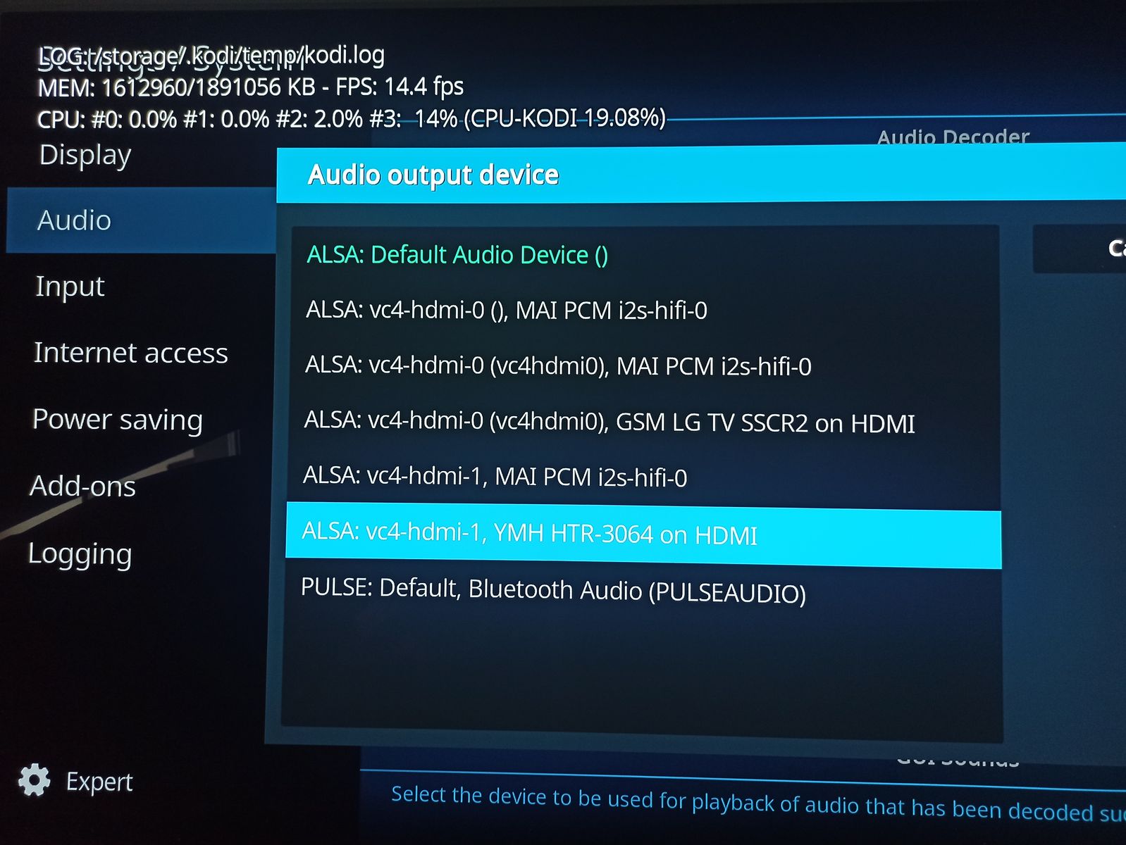

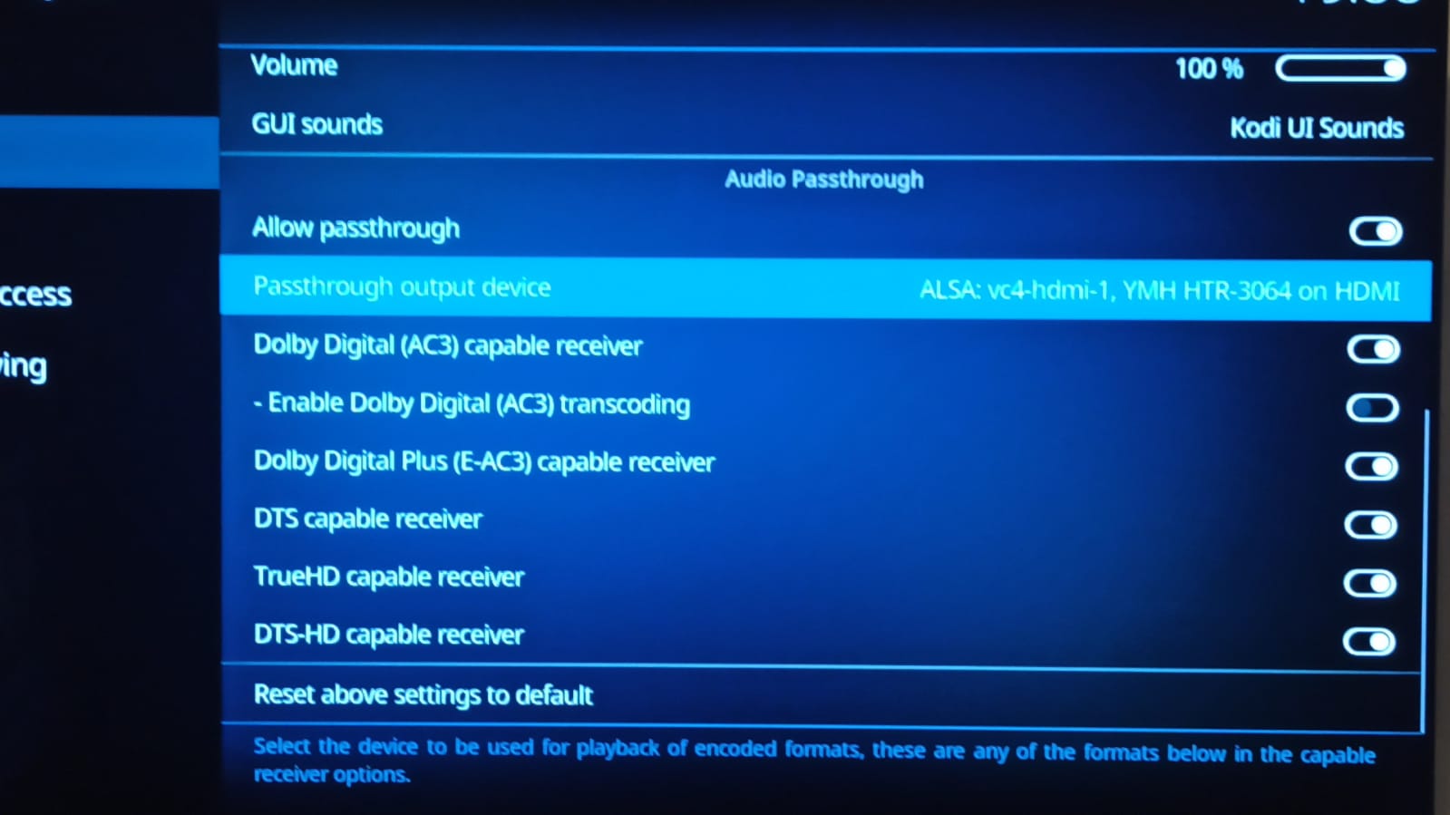

I'd like to provide a conclusion to this matter. At the time I captured the last screenshot, where vc4-hdmi-1 is recognized as YMH HTR-3064, the TV audio settings were configured as "Optical" (it's just a label).
Pros:
-In Kodi, the sound is send to AVR
Cons:
-In applications like YouTube, the sound is neither send to the AVR nor to the TV, resulting in no sound at all.
-I have to use the Yamaha remote control to handle the volume.

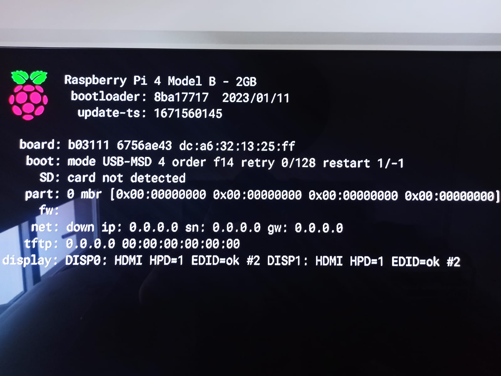

After testing and confirming that it worked well, I rebooted the system. Both the TV and AVR were turned on before the boot. Upon checking, I noticed that the EDID was now identical to HDMI-0, probably because the AVR and TV are connected via HDMI.
Although I wasn't concerned, I connected via SSH and ran "getedid create".
It's fine for me, I can live with that.
