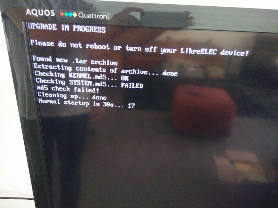

Winsat Model Combo Tuner AVL 6862. S905D. 1gb/8gb in my signature.
Fresh Install of 8.90.2
Update notification with the file successfully downloaded.
8.90.3
Rebooted with the screenshot error.
That file then gets downloaded again with the notification and reboot causes the same error and result.
Download got corrupted, it will attempt to redownload and apply again on next boot.
It's exactly the same as the old DTB, just the name is different, I never did anything.
The naming had to be changed to match what it will be called in LE9.0 official release. -
