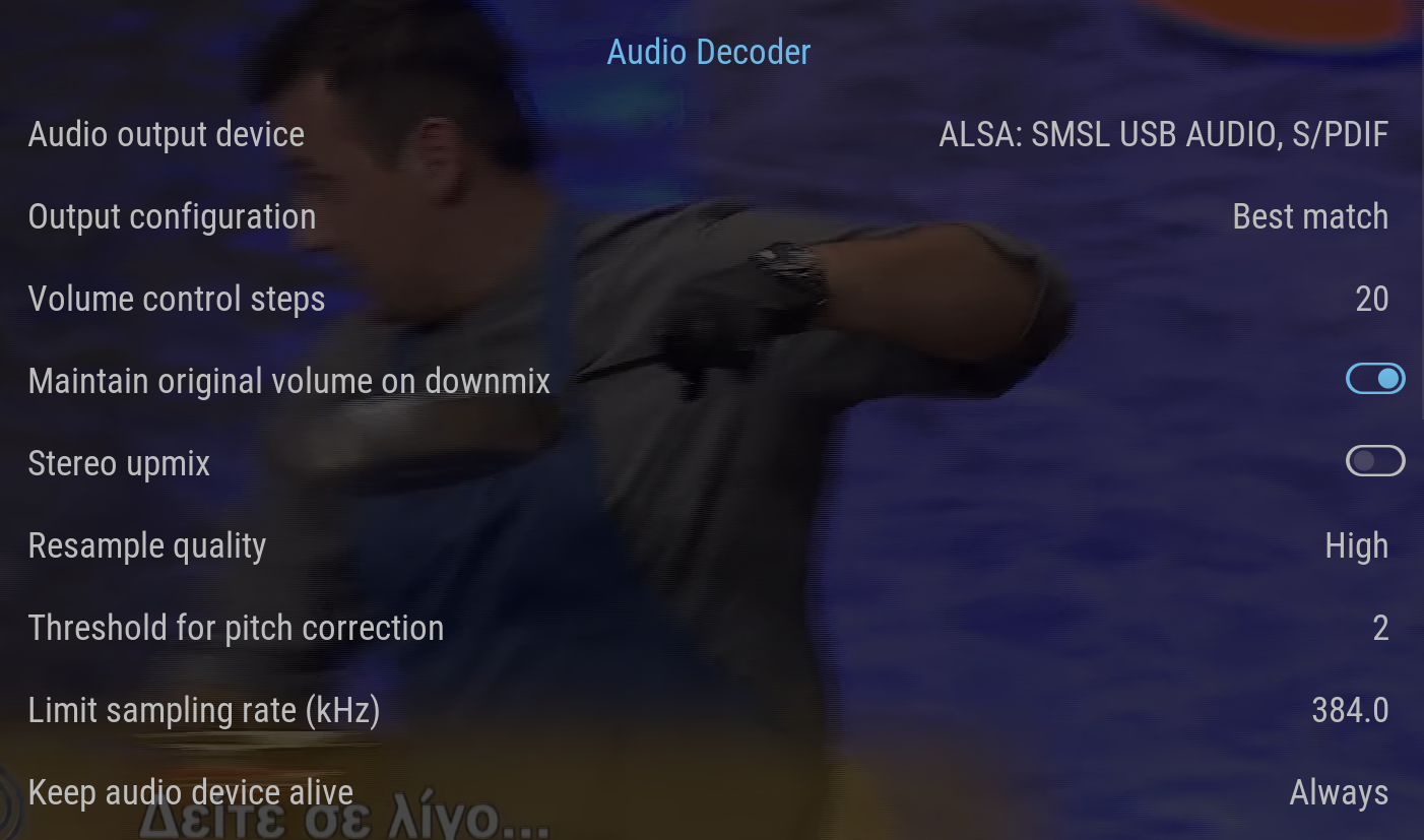

    Got the DAC today, I am posting the results so someone who's interested in it or DACs of similar chipsets will have an idea.
    I've read a lot of resources just to be prepared for this and I am amazed about the horrifical amount of misinformation circulating the web, especially in 'audiophile' circles.
    The DAC has two sinks, analog and spdif. The correct setting to use is spdif despite what you may read otherwise (like in the link I've posted). Maximum rate as reported by ALSA is 382kHz. The specific DAC should go to 768 but in all honesty who cares? The difference should be inaudible. The correct settings are:
    Output configuration: Best Match
    Max sampling rate: Whatever the DAC/Driver can handle. In my case it was 382.
    Maintain original volume on downmix: I really don't know. Its on now because I watch movies downmixed to 2.0 PCM but I have no idea if it can be harmful to the quality of a 2.0 music recording. Feel free to contribute here.
    Keep audio device alive: Always (this helps to keep the device alive in my particular setup because when I am using another input on the DAC with another device, for example toslink with another media player, USB ALSA seems to deactivate and I have to go though the settings again).
    Passthrough is irrelevant, That's the way it's supposed to be anyway because hi-res 2.0 PCM is not a passthrough format. I did not notice any difference in audio quality whether it's on or off, despite the experience of other users. I might have worse ears than them, I really don't know.
    With these settings it plays anything. Hi-res pcm flacs (up to 382), MQA and DSD. As a bonus I can play my downmixed films without changing any settings.
