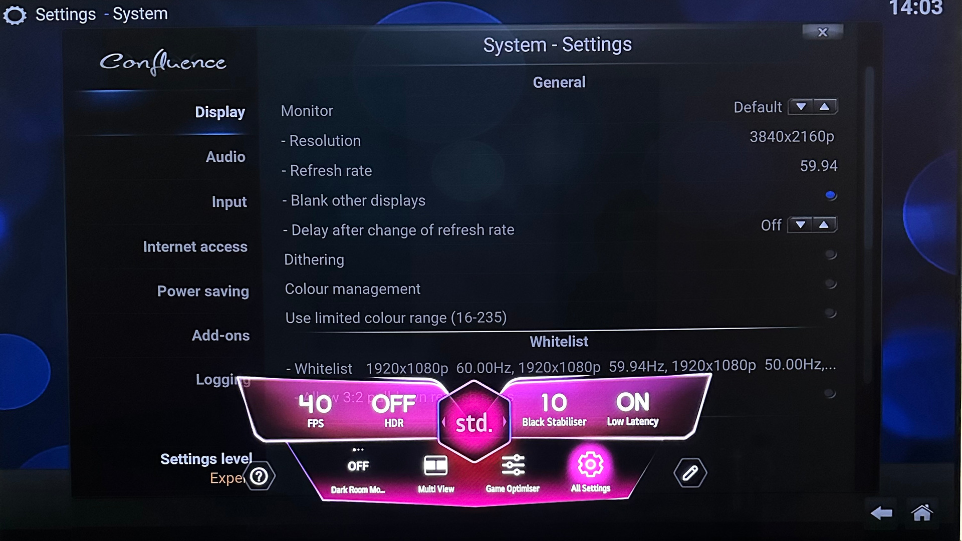

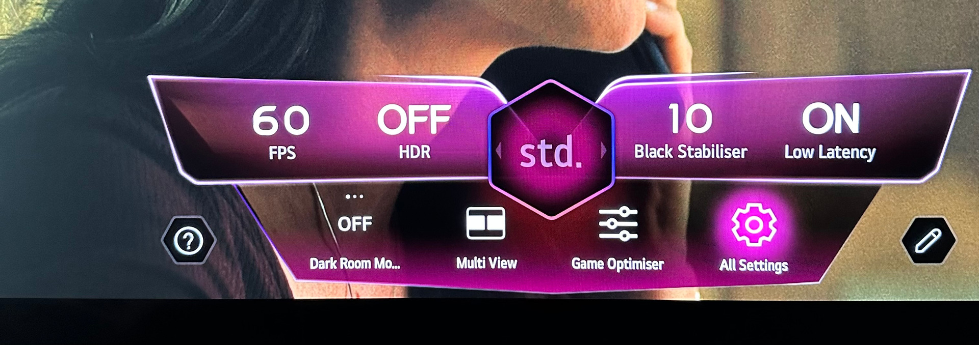

Hey HiassofT
I think a new bug was made when the nvidia fix solved the "blank screen"
I noticed it yesterday and tried a couple of things this morning. (tested 20250227, your build and 20250321)
the bug is not there in nightly 20250227 but is there after the nvidia fix.
Bug description: Whatever refresh rate you set in the gui, the gui its self does not use it, it uses 40hz always. when watching media its uses the refresh rate ive set (59.94) Ive tried other refresh rates but the gui do not follow it.
I noticed it because if i bring up my LG tv menu its very sluggish, i have "game optimizer" on and it shows 40hz.
I dont know if its a simple fix i can fix my self or a dev has to fix it. anyone can reproduce it by booting "live" from a nightly after the nvidia pr fix
