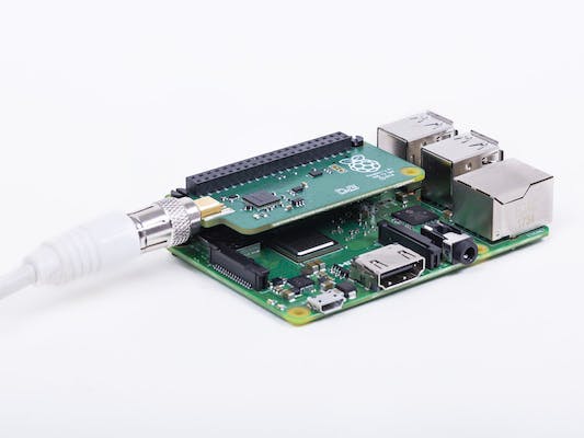

    This thingy effectively prevents you from having a heatsink? I don't see the point then unless you're okay with not fully utilizing your RPi 3/4 CPU and GPU. And Pi Zeros lack Ethernet so they won't make very good job of distributing channels to LAN. Personally I was thinking about getting DVB-T2 USB stick. But I don't know how good is their support under LE and Kodi.
