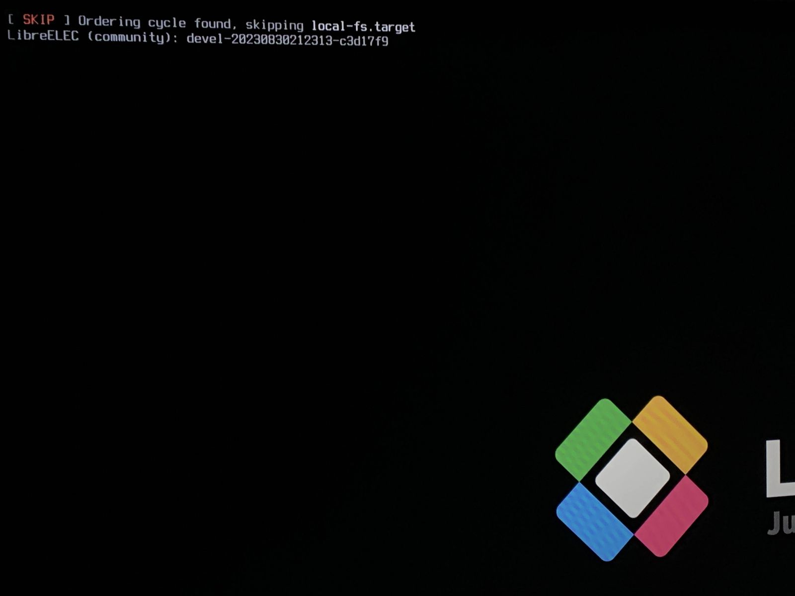

    so i took an SD card that i burned with the latest v12 nightly image, mounted it on a linux PC and replaced the SYSTEM and KERNEL files with the files from the "target" folder in the tar you posted. It booted up and was now reporting that it was running your development version. Did I do that correctly?
    Anyway it ran fine and was working, including CEC. But I left it idle though and it froze after about 20 minutes. After a power cycle it it immediately says "[SKIP] Ordering cycle found, skipping local-fs.target" and sits there.

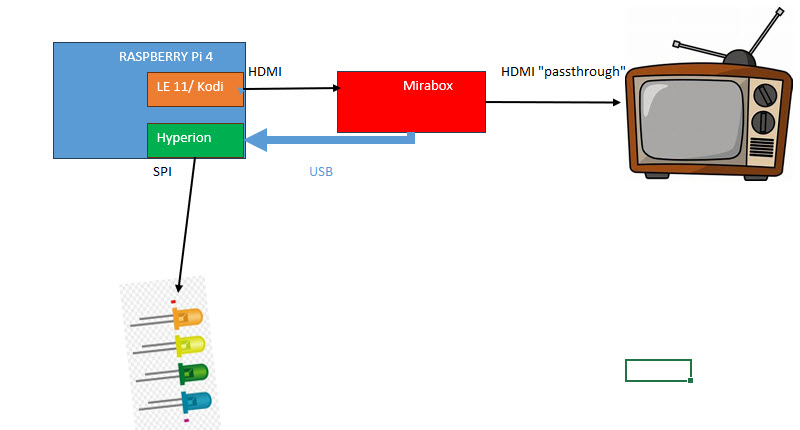

    My Mirabox arrived, and I set it up as shown in my diagram above. Its a partial success.
    The video signal passes through unmolested to the TV, and the Hyperion installation is able to simultaneously do screen grabs.
    But, the Mirabox blocks CEC signals from the TV getting back to the RPi4, so for this particular installation this won't fly.
    I guess I can try throwing some more money at this problem and order a splitter, maybe the splitter will have better luck passing CEC than the Mirabox did?
    Has anybody successfully seen CEC work through an HDMI splitter?
    --> Mirabox OUT --> PI 4 USB 3.0 IN
    When you say "Mirabox OUT", you mean the USB output, but I want to utilize the *HDMI* output (aka "passthrough") of the Mirabox.
    The RPI4 is going to be both the HDMI signal source, and is also going to have Hyperion running to snag the frames via the USB grabber and then that same RPI4 will control the LEDS. It seems bass-ackwards, but Hyperion can't frame grab directly from the V4L2 pipeline used by LE 11.
