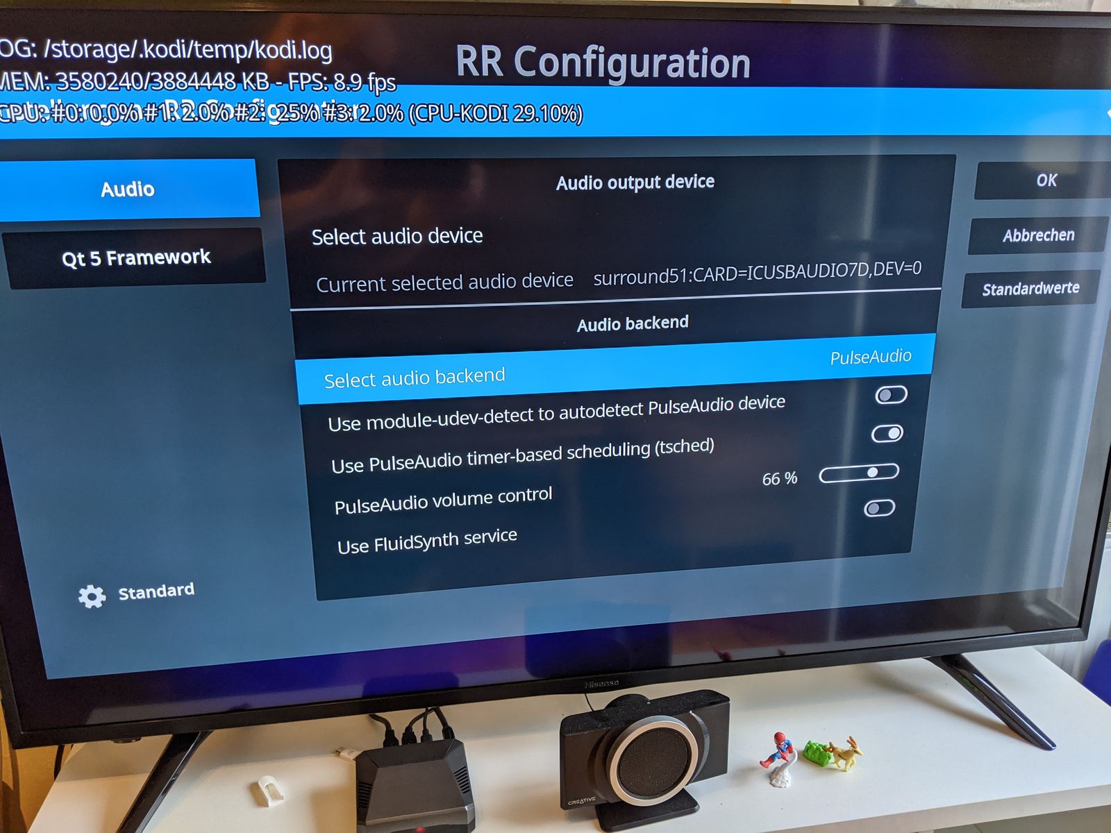

    Normally you have to enable the rr-config-tool addon, select your audio output, enable pulseaudio and you're done.
    So, if I just use the Libreelec-RR config tool with this settings:
    , I get wrongly mapped channels in Moonlight, Kodis audio output is fine, tested with a test file, that works on a Windows PC and Kodi.
    pactl info shows this:
    The default- channel map seems wrong. Here are the logs: http://ix.io/3yzJ
    If I select Use module-udev-detect to autodetect Pulseaudio device I get no sound at all.
    This is the output of pactl info is:
    Here are the kodi logs :log-2021-09-11-15.15.37.zip (Pastekodi didn't work and Pastebin complains about file size, I can give individual logs if you want)
    You don't have to manually edit any config files - if you do so you will break things because scripts adjust the automatically to match the audio devices
