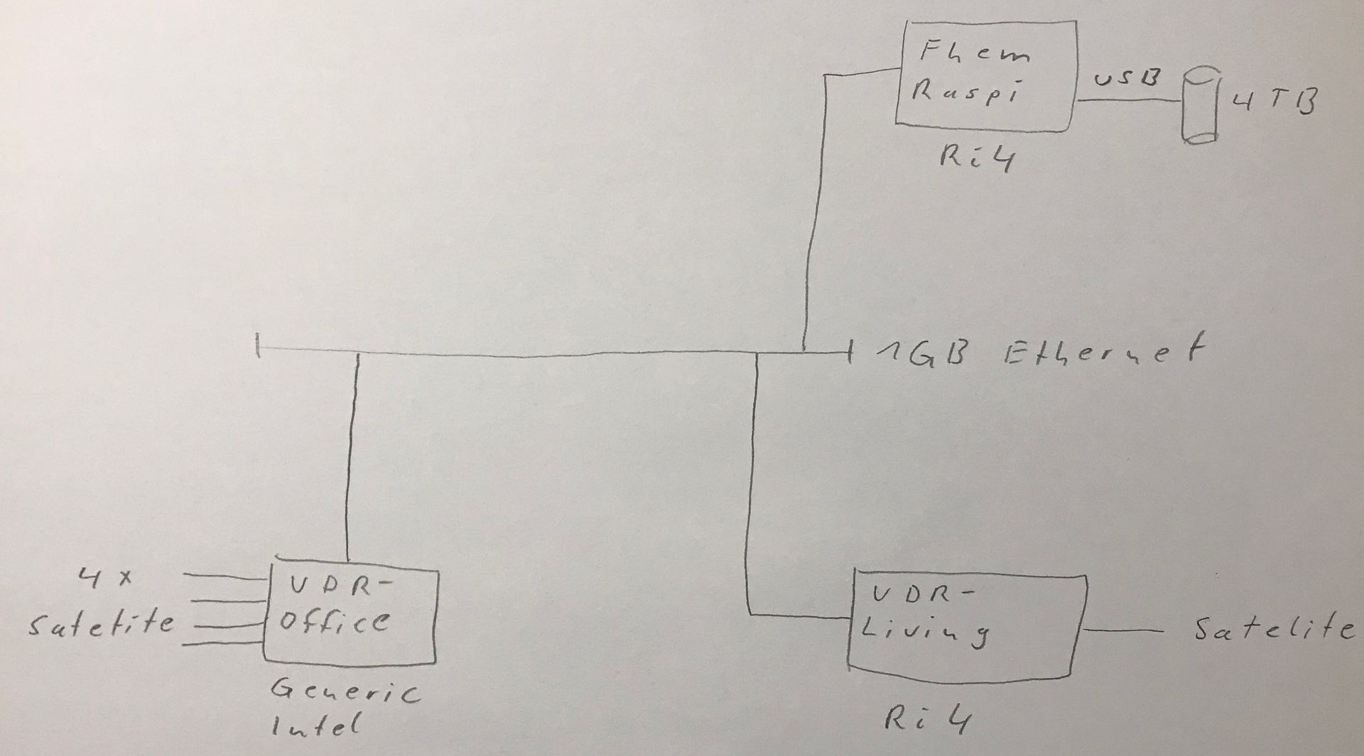

Hi guys,
when VDR-Office is doing more the 2 recordings at the same time replay on VDR-Living is chopping, both using NFS.
If I do the repay on VDR-Living using Samba it works fine.
This is a rough drawing of my LibreELEC setup.
NFS mountings:
VDR-Office:
/storage/videos -> FhemRaspi:/srv/vdr/video
VDR-Living:
