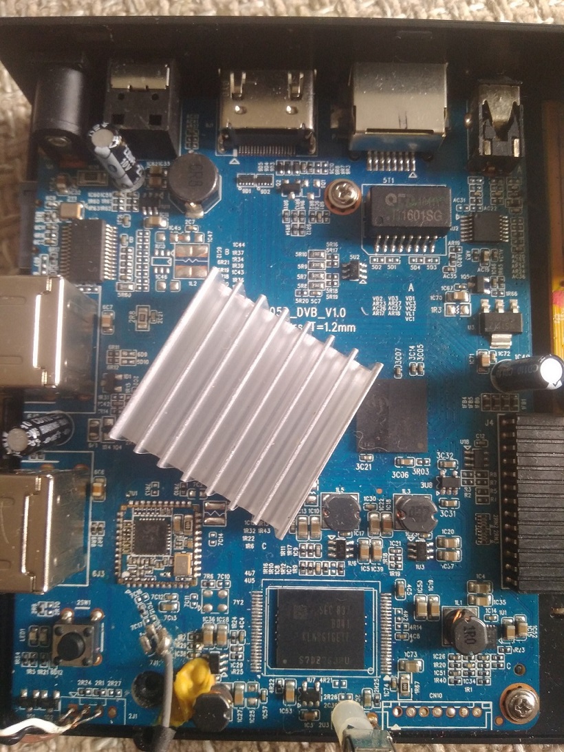

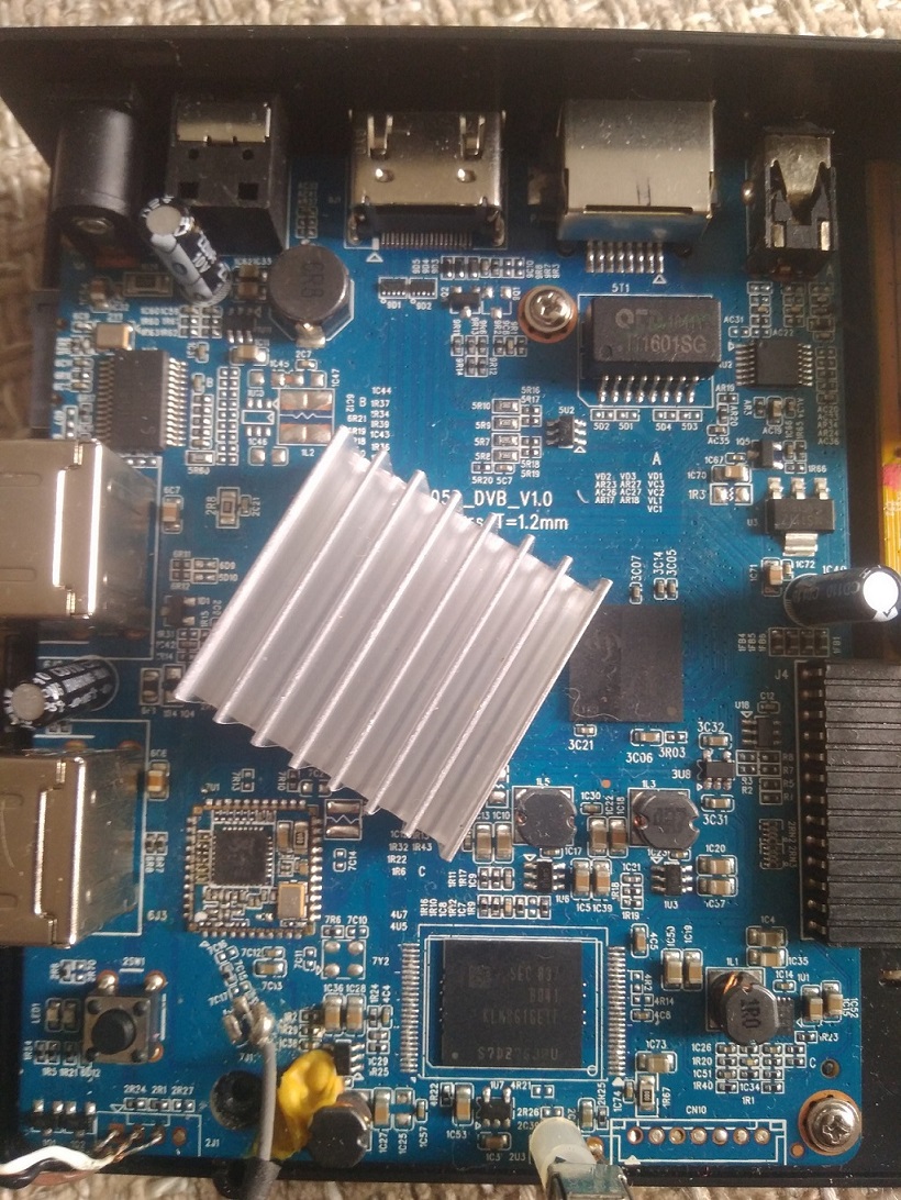

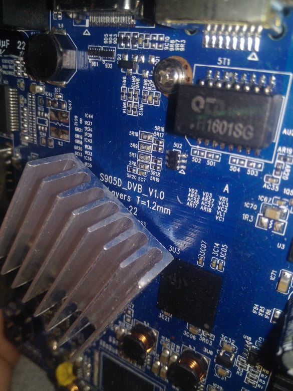

    Please take some box and board photo.

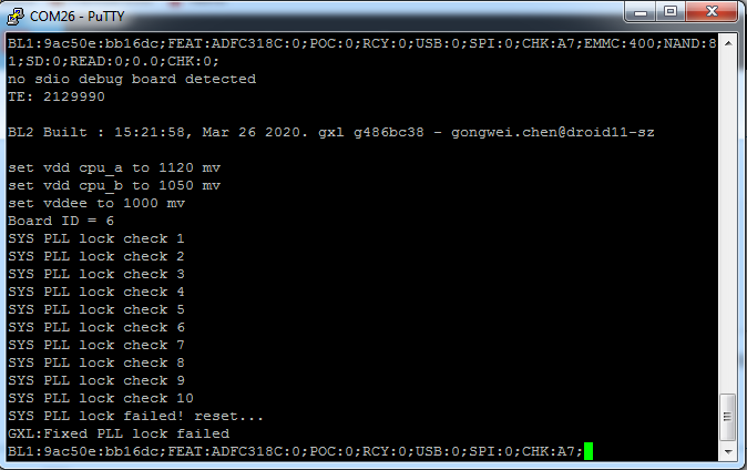

    Ah ok. But I still don't understand how flashing the gxbb fw could affect the boot ROM (BL1). Additional start devices SPI and NAND appeared in the BL1 boot sequence. Ok, let's assume - the card reader in your box is no longer working or the SD card is defective. This could lead to incorrect loading of BL2. I will create an aml_upgrade_package.img file and integrate the new u-boot. You will try to do the USB-burn via UBT.

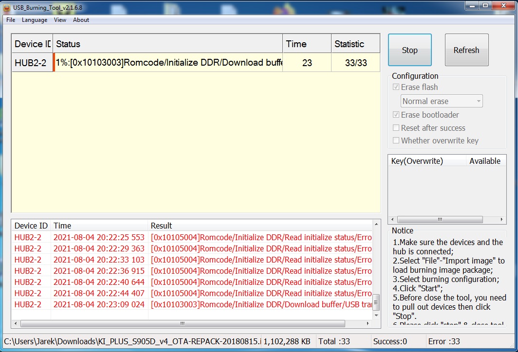

    see the logs from UBT and aml flash tool from linux. UBT shows 0x10105004 error

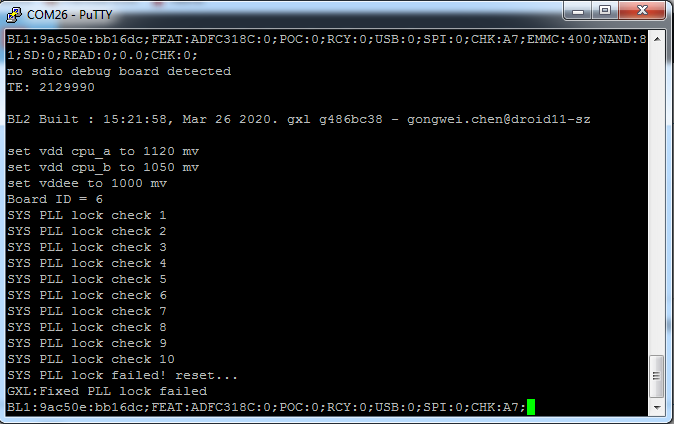

    BL1:9ac50e:bb16dc;FEAT:ADFC318C:0;POC:0;RCY:0;USB:0;SPI:0;CHK:A7;EMMC:400;NAND:81;SD:0;READ:0;0.0;CHK:0;
    no sdio debug board detected
    TE: 2129999
    BL2 Built : 15:21:58, Mar 26 2020. gxl g486bc38 - gongwei.chen@droid11-sz
    set vdd cpu_a to 1120 mv
    set vdd cpu_b to 1050 mv
    set vddee to 1000 mv
    Board ID = 6
    SYS PLL lock check 1
    SYS PLL lock check 2
    SYS PLL lock check 3
    SYS PLL lock check 4
    SYS PLL lock check 5
    SYS PLL lock check 6
    SYS PLL lock check 7
    SYS PLL lock check 8
    SYS PLL lock check 9
    SYS PLL lock check 10
    SYS PLL lock failed! reset...
    GXL:Fixed PLL lock failed

    I would really suggest you to try to use a UART cable, to check exactly what is happening with your device.

    Now you just plugged in the UART and got this output, or did you even manage to flash the image I linked earlier?
    Amlogic burning tool still showing error with all images, also yours.
    [0x10105002]Romcode/Initialize DDR/Read initialize status/USB Control setup error.
    in UART unchanged : BL1:9ac50e:a1974b;FEAT:ADFC318C;POC:3;RCY:0;EMMC:0;READ:0;CHK:AA;SD:0;READ:0;CHK:AA;USB:8;
