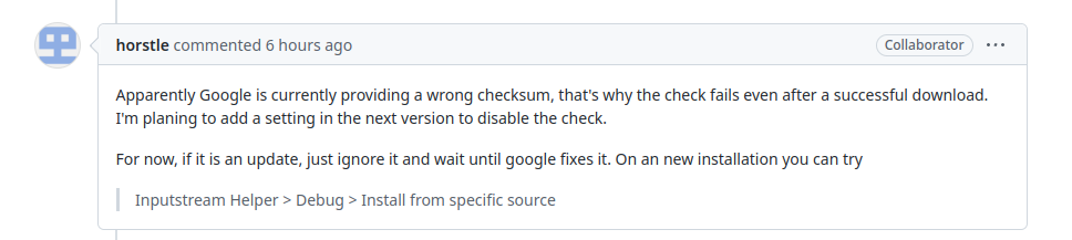

    There is another addon for installing Widevine, you can google for "SlyGuy Common" and see if that works. It doesn't use ChromeOS images, instead he hosts installs for the library.
    I have installed its repo. It doesn't have any option to install widevine. The easiest way was to go to the input stream helper settings and choose "install from spesific source" under debug.
