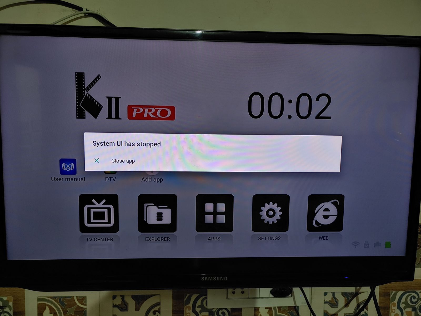

above Method fallowed
WiFi Bluetooth still not working
error system UI has stopped is flashing on screen again and again....
edit
In my observation, system UI stopped error comes when,
"system first time initialization of app" not come on android first boot..

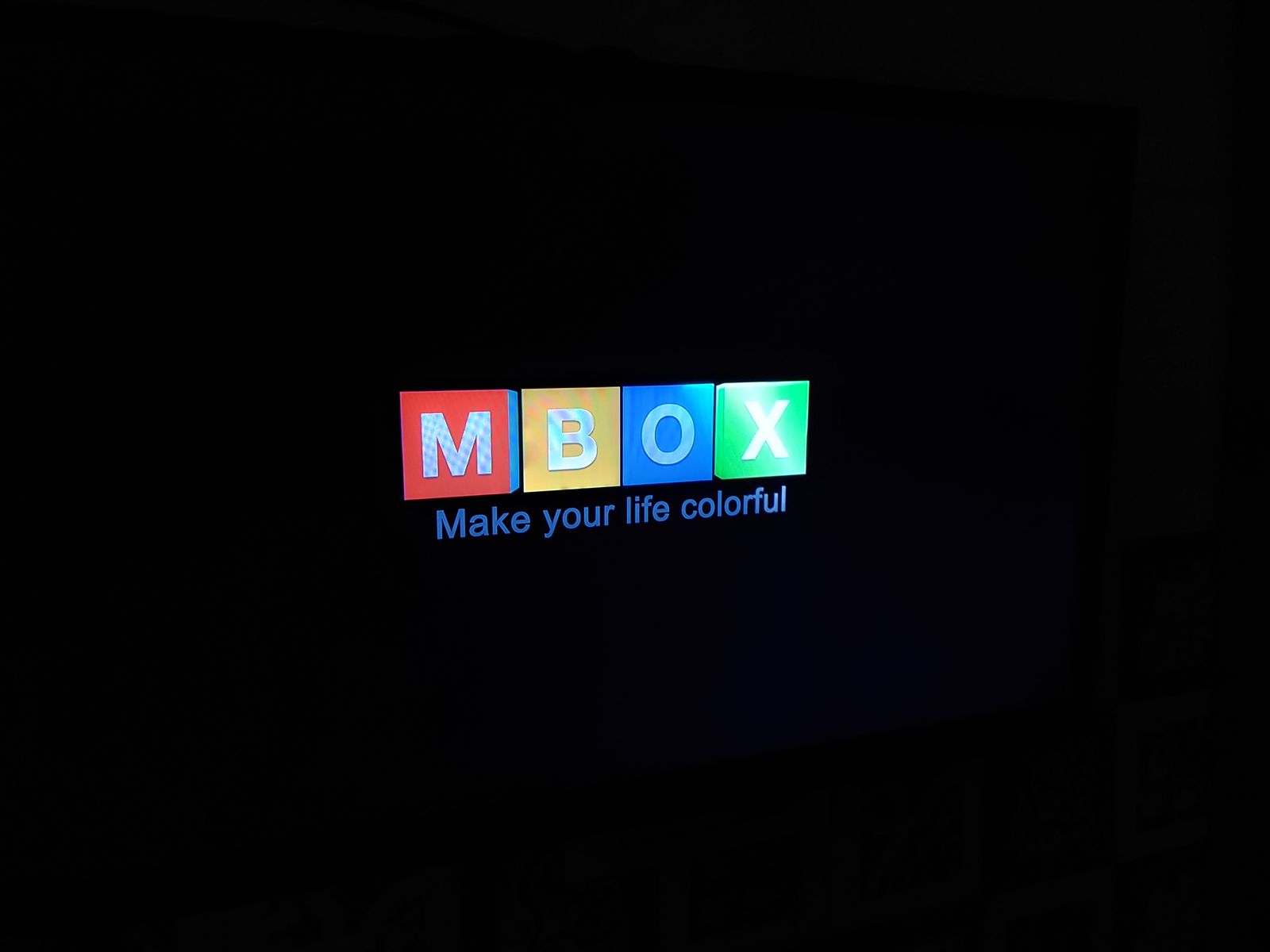

today i tried USB burning method
Replace all 04 files, (stock image used, provided by you previously)
and packed the image and burned through USB,
Device booted after reset, but it was giving error "system UI has stopped" after booting
then in same image repacked with replacing only 02 nos files only uboot and uboot sd
and after usb burning, device booted, but wifi and bluetooth not working in this image
uart log of successful boot is attached...
