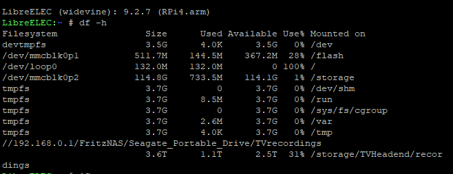

    First of all I found out, that MC obviously is showing some "random" numbers.
    The "easy" way I was looking for to browse my SD-card was the command "df -h".
    Luckily everything is fine :)

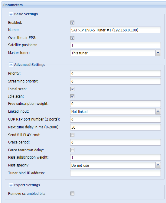

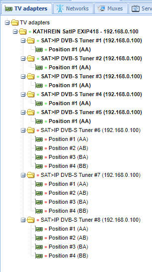

    My adapters look like this:
    Its the same like you, but with checks at "addpids/delpids supported" and "FE supported".
    But I didn't do them manually for sure.
    Also the later settings (e.g. "send rolloff settings") is not availlable in my Version of TVH (its 4.2).
    That one looks different than yours. I have "advanced settings" there aswell.
    Last one looks different than yours aswell.
    Anything I shall change? (E.g. the ones you have turned off "addpids/delpids supported" and "FE supported".)

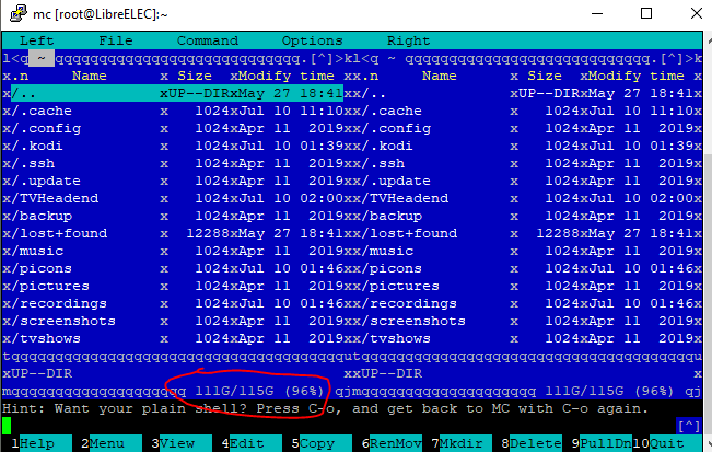

    When I was serching for the log file I noticed that MC showed 98% usage. And since I am kind of unable to browse/screen from SSH terminal I tried to link the SD-Card to my card reader. Sadly I can't see anything but the "boot" on the SD-card from windows.
    After putting it back to the raspi it now shows 96%:
    Does that actually mean free or occupied? Since 98%/96% occupied woul be a nightmare I guess?
    How can I browse/screen/search my drive in convenient ways, to find out in which folders large data was written (and when)?

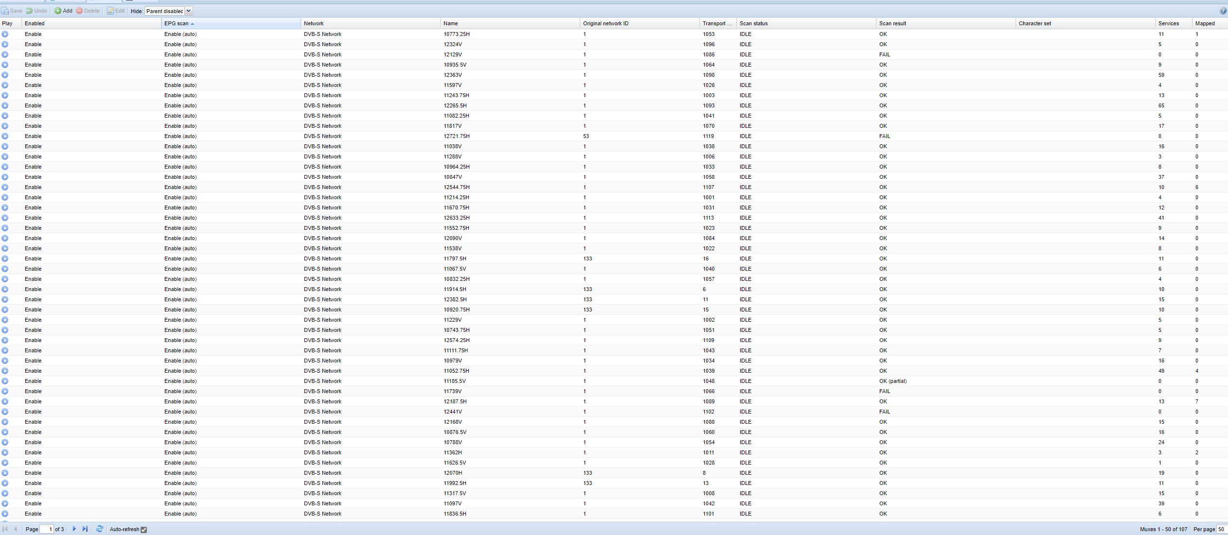

    With the "30+" lines I meant the Muxes (and its even 107):
    Sadly I don't have deep knowledge "how to set-up TV Headend and how to set-up your SAT>IP receiver within it" - no. :(
    I used the auto setup wizard to do so.

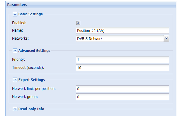

    But that wizard removed the positions 2-4, as you mention:
    Only using 5 is intended from my side. To always have 3 spare ones to use for other needs (VLC, SIPTV app on the TV e.g.).

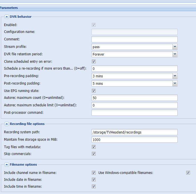

    I think first of all I need to provide a log where TVH is displaying the cont. errors.
    The best would be to have one directy related to a recording (like I provided from DVBViewer which has a dedicated check box for "write log with recordings" in the recordings-setup page).
    Because there I can directly check at the timesstamps on which I see the artifacts in the mpg to have a relation.
    But I can't find such a setting in THV:
    Is there a chance to do this with post processing commands?

    maybe you enabled some setting that created that problem ? normally you can keep everything at default and it should work okay at least
    I guess you overloading the satip device (I have no experience with that particular one), so it is possible that you have corrupted output at a single tuner.
    If you had enabled the idle scan this might fix it.
    Well, the artefacts were reduced a lot with the reinstall . But sadly that they are gone was a false alarm. They are still present like 1-2/min.
    Overloading the Sat-device is not the cause. I tested with all 5 streams running on my PC with VLC player and watched TV over DVBViewer. Still no issues.
    But on the other hand if only 1 Tuner is running via TVHeadend I already see those artifacts.
    The "5 tuners running" was another false alarm from myself, it always happens after restart of the device for some minutes. But after that "setup" THV drops them again and only occupies used ones from then on.
    Where can I turn on the "idle scan"? I couldn't find that option in THV.

    Today I de-intalled and re-installed TVHeadend.
    With checking for like 3-5 minutes the artifacts now are gone !!!
    Also I dont have any cont. error since the reinstall:
    Very strange ?!? (I didn't plug in or out anything for the THV reinstall - all doine over the add-on page in Kodi.)
    I will report tonight, when I have time to watch TV for a bit longer, wheter the fragments and cont. errors are (hopefully) gone forever.
    But another very strange thing is:
    after this reinstall I now have all 5 ports open all the time (I binded only 5 of the 8 to THV):
    As you can see from the load (and network needs) they are not really doing much (if I use all 5 ports to actually stream sth. , then cpu load is ~15% and network ~15MB/s).
    But before the reinstall it always went down to 0 again (or the number currently used) when I turned off streams on the clients.
    When I restat the RasPi it goes to 0 (during the shutdown reboot tmes), but shortly after booting the EXIP show "5" used again.
    Any explaination for this?
