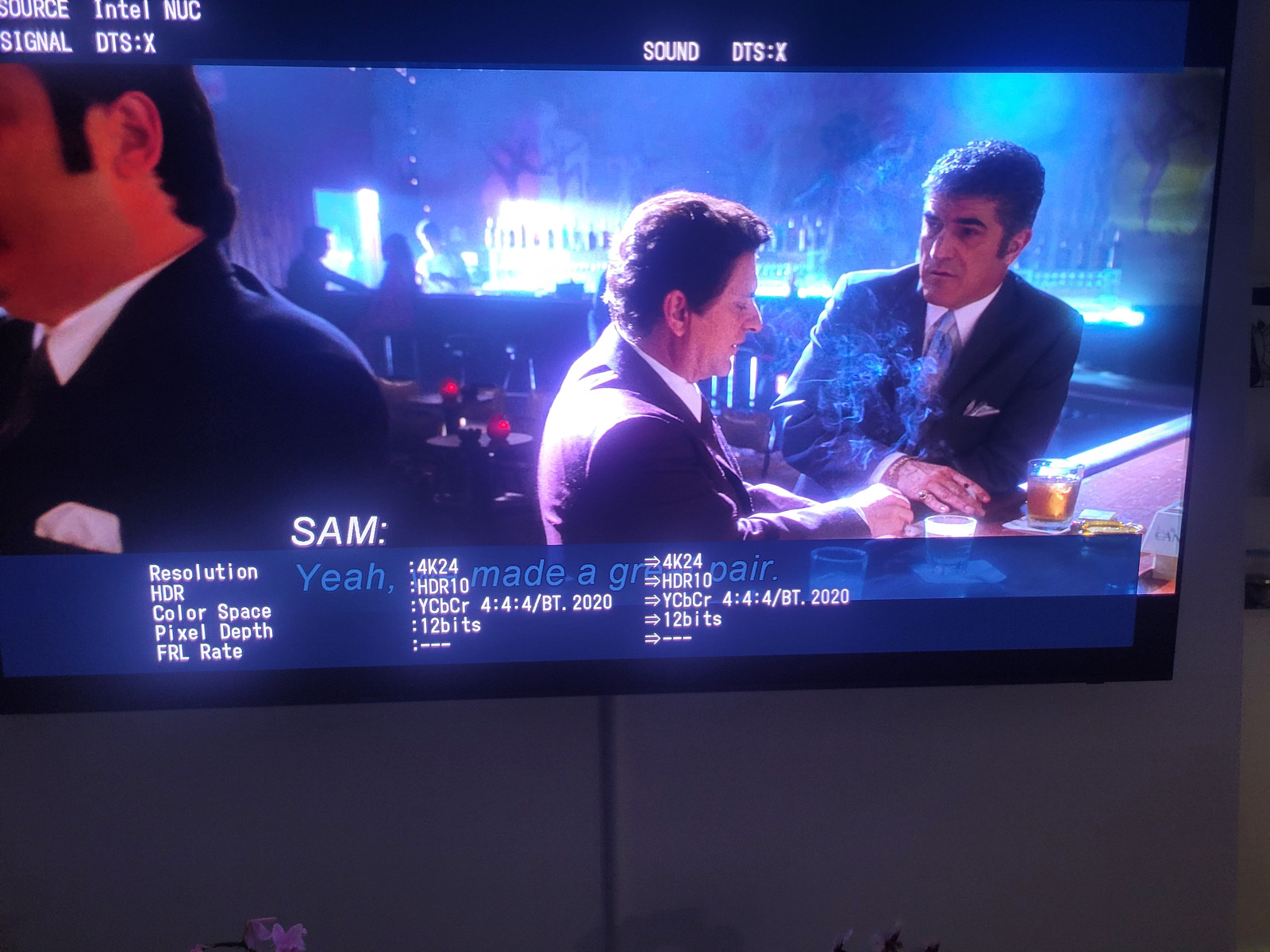

I had some time and configured the amd radeon and now the denon receiver shows the information on the attached image.
I'm using a standard install of libreelec 12.2.0
Is this the best I can get at this point in time? Should it be using bt.2100 colour space instead of bt.2020 ? apparently the receiver and TV support it.

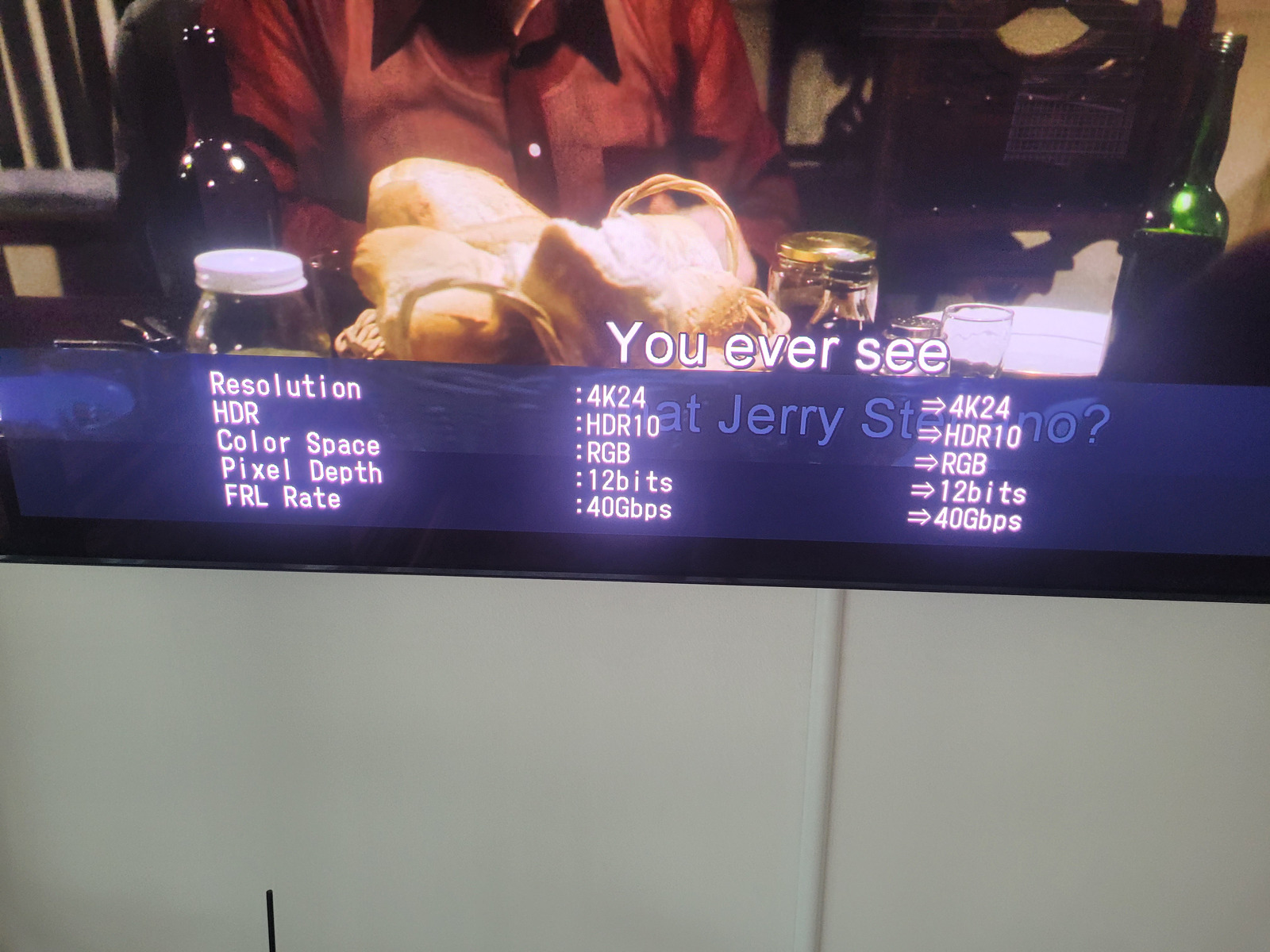

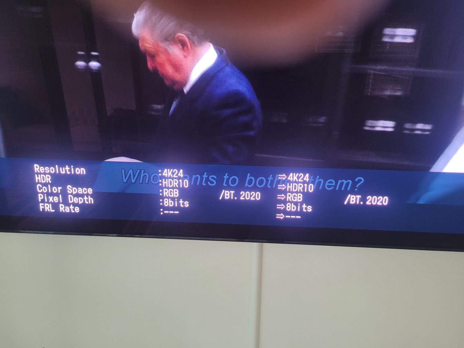

After some free time available I ended up finding a cable (after testing a FEW) and plugging it in to the DP(LSPCON and TrueHD and DTSHD audio work without issue on a intel 11 i5 nuc.
But using this type of cable it says the source is 8bit and / bt.2020
Whereas using the hdmi port it says 12bit
Forgive my ignorance but could someone explain what's going on here?

It did not and also the video was reduced to 8 bit for some reason.
