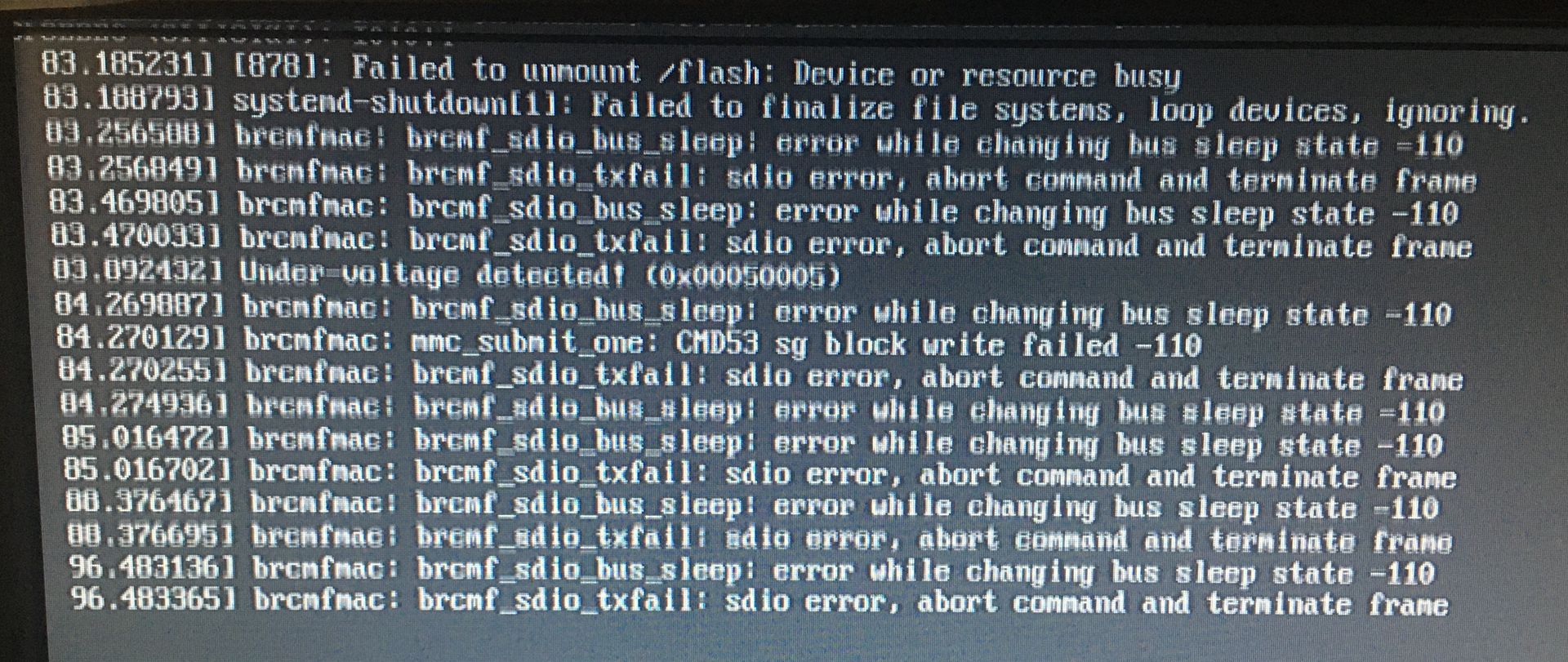

    Use a better power supply (the official RPi one is highly recommended) and/or a powered USB hub or USB drive.
    I was using a 2A USB adapter at first. When I use it with Raspberry Pi OS, it shows the lighting bolt symbol. After seeing the "under-voltage detected" message I switched to use my iPad's 2.1A adapter and still got the "under-voltage detected" message.
    Why does it say under-voltage, and not low current? I can trust my iPad charger is outputting 5.1V. Would this message appear if they current is too low. You think I need the 2.5A to work with my hard drive?
    I'm running LibreELEC 19.5 on my raspberry pi 3.
    When I shutdown/reboot I get errors:
    Failed to unmount /flash: Device or resource busy
    systemd-shutdown[1]: Failed to finalize file systems, loop devices, ignoring.
    9053-img-6031-jpg
    It seems to only do this when my main 1TB hard drive is connected. If there is no drive attached it's fine, and when I connected another usb drive it didn't cause errors either.
    Because it says Failed to unmount /flash, I thought this was probably to do with the fact I've added support for an IR controller. In doing so, I had to mount -o remount,rw /flash, edit the config.txt and then mount -o remount,ro /flash. However I took another identical microSD card and started fresh with a new image of LibreELEC without configuring the IR, using only a usb keyboard, and the same errors happened when I shutdown.
    When I try to unmount the hard drive with umount /dev/sda1 it still produces the errors until I physically pull it out of the usb port. Then it shuts down ok.
    If I run df -h, I can see that /dev/mmcblk0p1 is mounted on /flash. When I try to unmount it, I get umount: can't unmount /flash: Device or resource busy.
    What's could be this to not shutdown correctly?
