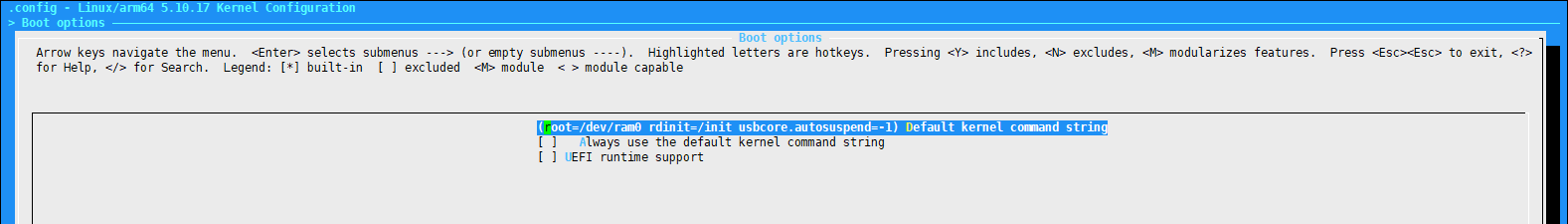

    The image error is generated below, it is due to the lack of dtb file, is it because ARCH=arm64 is selected in the menuconfig configuration, which causes this error?
