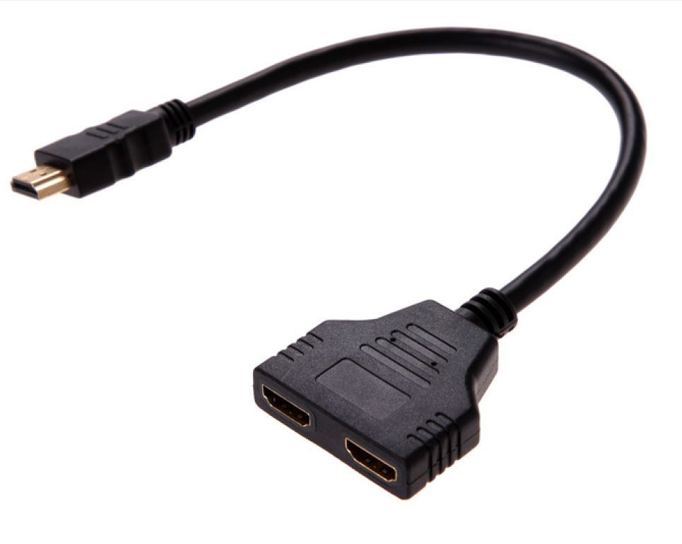

Thanks for the response. Maybe I misused the term, with the 8.2.5.1-444-1000nits update I no longer get any 4k video to my TV. My setup is HDMI out of the box into a Yamaha YSP-2700 soundbar which supports 4k video passthrough to my TV. With 8.2.5 422 10-bit, 4k HDR played just fine, audio decoded as it should and video passed through to my TV in the correct format. After updating to 8.2.5.1-444-1000nits, when I tried to play a 4k file my TV would just tell me there was no source but the audio would still decode and play fine from the soundbar.
Curious to know if the the 8.2.5.1-444-1000nits update made any difference for you in regards to the brightness of your 4k HDR rips?
Try a 1 M to 2 F hdmi splitter.
Any idea why?
No idea though.
