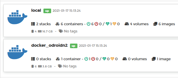

Hi elonesna. Thank you for that suggestion. It might be slightly overdoing it for my initial plan though. Maybe I should have elaborated a bit.
I have a portainer on another server. On that I have 2 "homes" as seen here, one on the local machine an another on an odroid.
So I just wanted to be able to add the docker service running on libreeelec to this list as well. But it is somehow setup in a different way than all the guides are explaining.
Hi
I have been trying to enable remote management of docker but the guide I try to follow seem to not work for libreeelec. dockerd | Docker Documentation
So how can I manage the docker containers on libreelec from a remote portainer?
