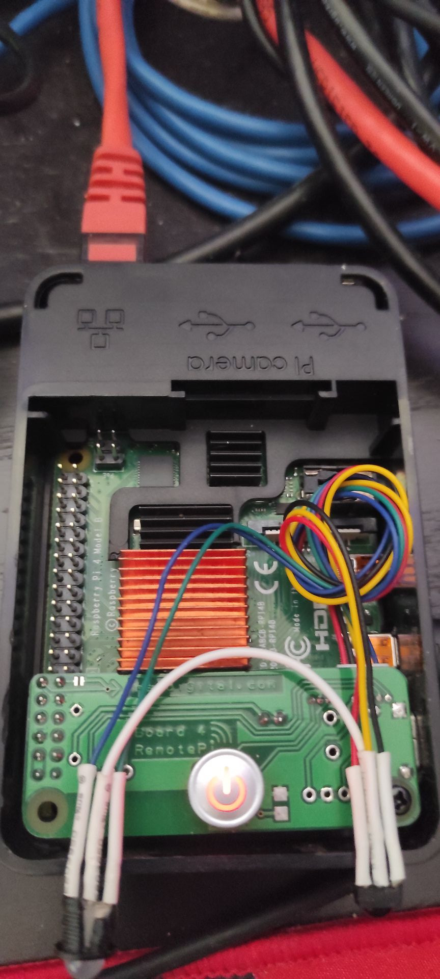

Ah, this is important information. I highly suspect your poweroff/reboot issues are related to that hat - haven't seen anything similar on plain RPi4 installations (reboot, poweroff and then powercycling and gpio-shutdown overlay with a button all work fine).

I was able to pinpoint the issue. It seems related to the hdmi switch that I have. When a second computer is connected to the hdmi switch although it is not currently selected by the switch it seems to be powering the switch. Somehow this power reaches the pi through the hdmi port (I was able to verify this during shutdown of the pi I disconnected the power cable and the pi still gets power....) Not sure how this is possible but if I disconnect the second computer from the hdmi switch all works perfectly.

I have this hat
https://www.msldigital.com/collections/al…=30268836610182
which is a power switch for the raspberry pi.
