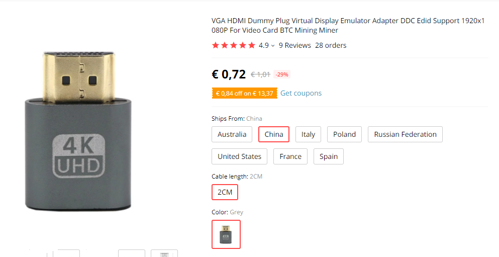

    During the LibreELEC installation I used the HDMI2 port of the PC. LibreELEC configured itself to boot on this port. A few days later I switched to the HDMI1 port and thereafter LibreELEC was unable to activate the TV when it was turned on later than LibreELEC.
    Conclusion: LibreELEC configures itself to turn on the TV during the installation process.
    More informationfor for x86_64 processors here EDID - LibreELEC.wiki.
    Turn on the TV first, then the RPi... LibreELEC needs to do a HDMI-handshake, which isn't possible when the TV is off.
    Also, read here: "No signal" on TV with Raspberry Pi 4, after LibreELEC logo.
    "Turn on the TV first" - Not possible, the PC works 24/7. It is a TV server (tvheadend), multimedia server (Samba and FTP) and automatic smartphones backup server (syncthing) for my house and the houses of my relatives (zerotier-one). It reboot at dawn when all the TVs are off.
    "then the RPi ..." - It is not an RPi, it is an x86-64 PC, the solutions in the link do not work.
    Note.- When the LibreELEC server starts up with the TV turned off, a VNC session (tigerVNC) can be started but always in "virtual screen" 1024x768p60Hz mode and no other resolution can be chosen. When the TV is on and LibreELEC is working fine, then multiple resolutions can be chosen. I manage all LibreELEC and CoreELEC devices from my smartphone. With CoreELEC and ARM Amlogic processors as a server I never had any problems.
    The command
    /usr/bin/xrandr --output HDMI1 --mode 1920x1080 --rate 25
    works inside SSH but not inside crontab.
    If my TV is off when LibreELEC starts up then there is no HDMI signal when I turn on the TV.
    I have not been able to solve the problem, only assign a key on the remote control to restart the mini PC with the TV on.
    Does anyone know how to solve this problem other than restarting the mini PC with the TV on?
