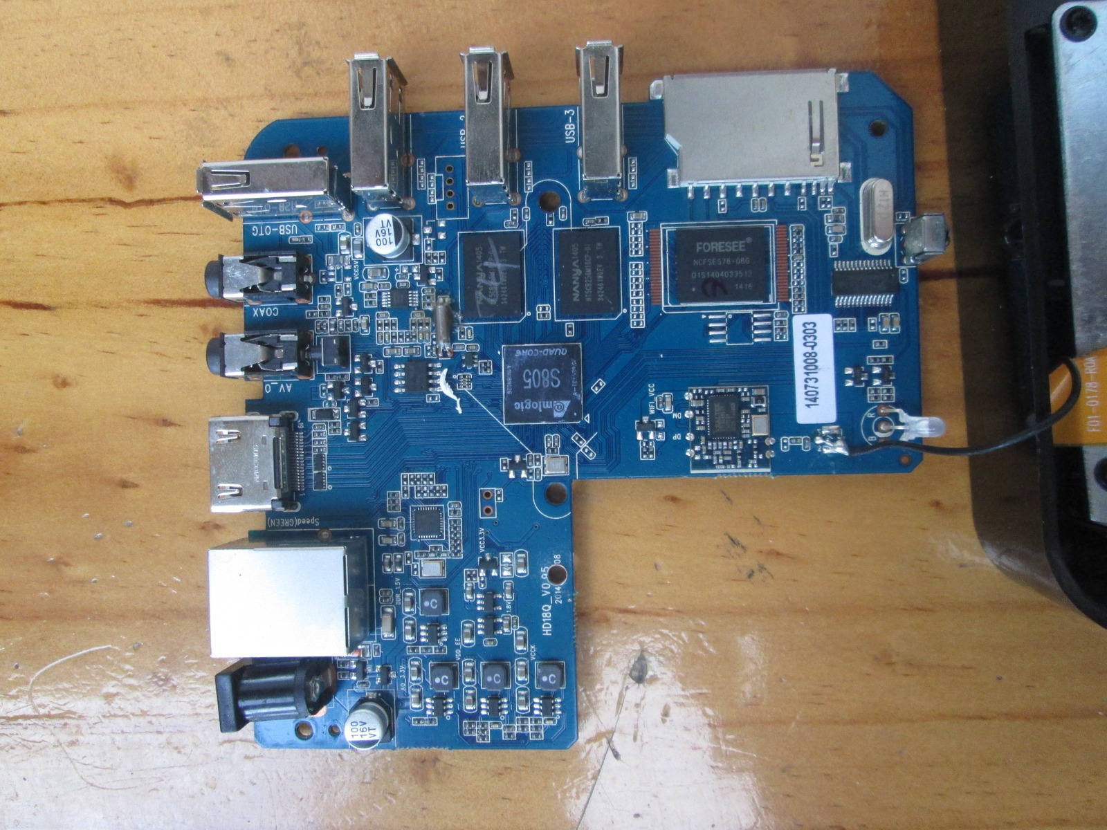

    the 45 degree rotation on the chip makes Amlogic unlikely
    There is a HD18Q marking on the PCB, so I'm 99% sure that there is an Amlogic S805 SoC under the heatsink.
    It looks very similar to the Eny EM6Q-MXQ PCB, which also had a 45 degree heatsink, although there is no battery for the RTC.
