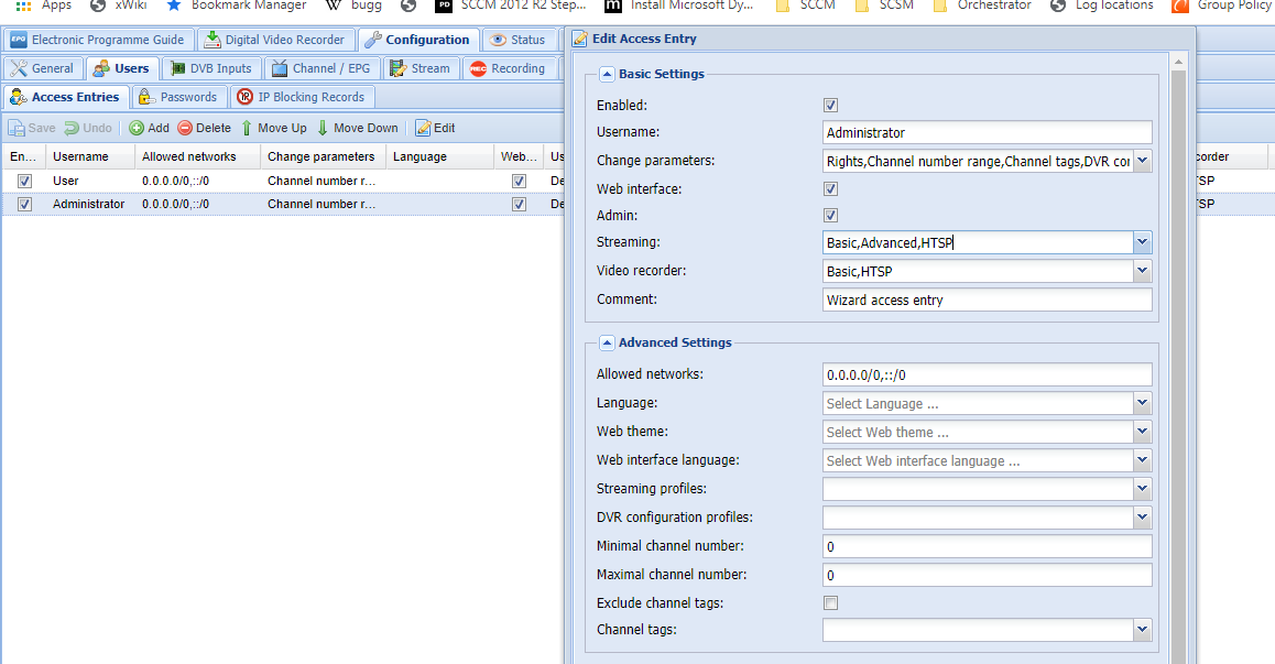

    go to Configuration~Users~Access entries and click on the account you r using...in this case administrator then click edit...and check that the streaming profiles you r using are all enabled for that user..I have a feeling htsp is not enabled properly and your setup is defaulting to some transcoding profile..
    Menu looks like in this image:
    m1zvLaD
    Just checked and all profiles appear to be enabled.
