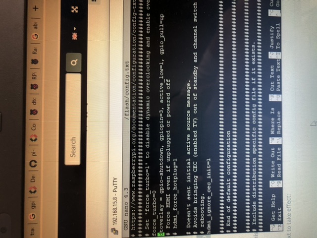

Da Flex Before updating the firmware, the command for wakeup did not work, but after I updated the bootloader, I turned the LE off and when I used the power button it turned on, but it didn't! after I changed the command “dtoverlay” as described above he started to turn LE off by the power button! but now the led script is not working! I would like help! do you have a log where you can see if the script is being executed by autostart.sh?
Posts by Allissonhsp
Da Flex I updated the boot firmware and not the LE! my LE is in version 18.5! the problem and in fixing the bootloader of rpi 4
Da Flex I found the power button problem! first I had to update the boot firmware, then it started working to restart, looking in the forum I found the error in the instruction dtoverlay = gpio-shutdown is wrong, it should be written: dtoverlay gpio-shutdown so it worked! now the led script is not working! I don't know why he doesn't perform!
Da Flex I was trying the command chmod + x /storage/.config/autostart.sh and returned an error of: -sh such file or directory, but I ran the rais and did not return any error! but the power button still doesn't work!
Is the command in the config.txt file correct? because the button is not working!
