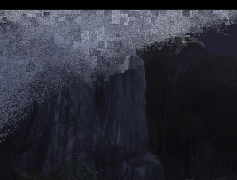

    Unfortunately, some 4K movies still show artifacts at the top of the frame which "bleed" down into the picture. The stuttering and hesitations are gone, now. Thankfully.
    This happens on several 4K movies (Stream #0:0(eng): Video: hevc (libx265), yuv420p10le, 3840x1608 [SAR 1:1 DAR 160:67], q=2-31, 23.98 fps, 1k tbn, 23.98 tbc (default), if that's helpful).
    They play ok on my laptop... but it has a GPU, and I suspect that could be key here.
    I've attached a screenshot of the offensive artifacts. The more action, the more of them there are. I had to severely cut it down, as there's apparently a 1MB file size limit.

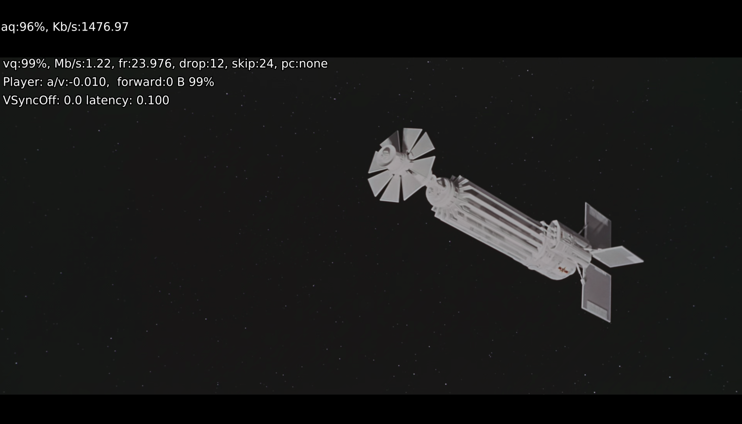

    The 2001 ASO movie continued to give me hesitation issues, so I decided to switch media to a smaller file of roughly the same resolution.
    This one is apparently 3840x1744 23.976. The hesitation is still there, although subjectively milder.

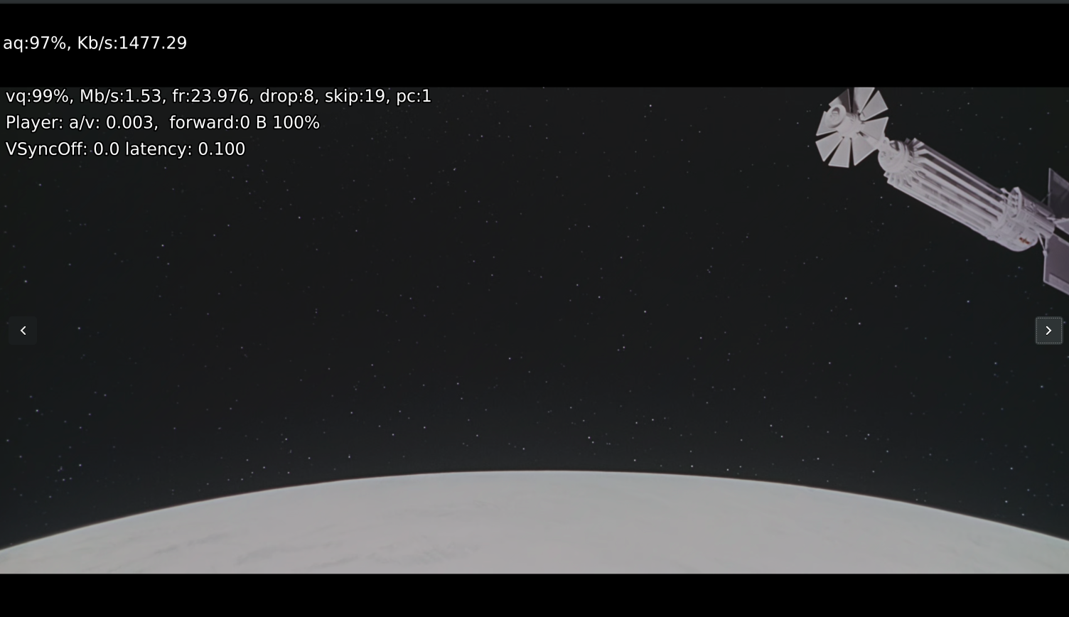

    I discovered a few new tools to use, so here's a screenshot or three....
    These two show an increase in drop and skip values. Unfortunately, I soon learned that these only occurred when I took a screenshot. As I watched the movie with these statistics running, I never saw either of these go up spontaneously. So the hesitations are not due to drops or skips, imho.

    Kodi debug log while 4k movie is running - Pastebin.com <- the log

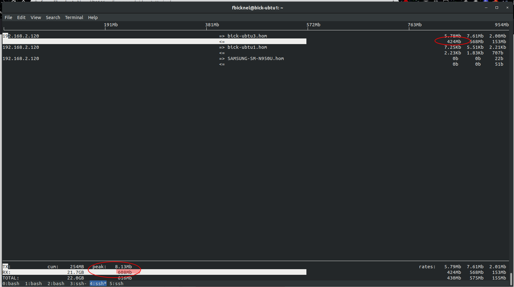

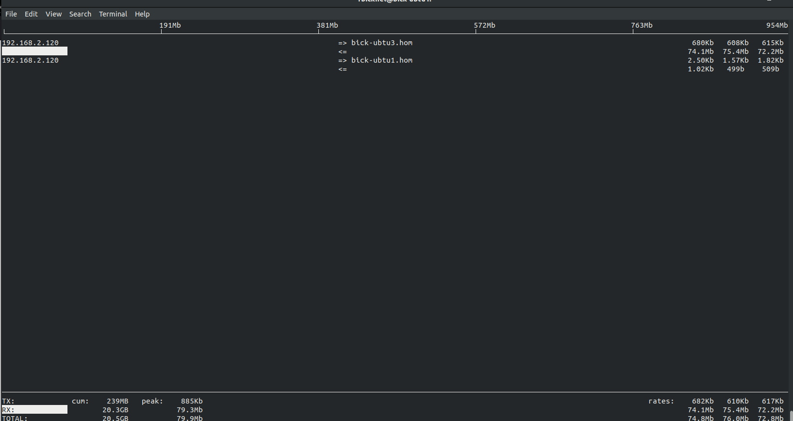

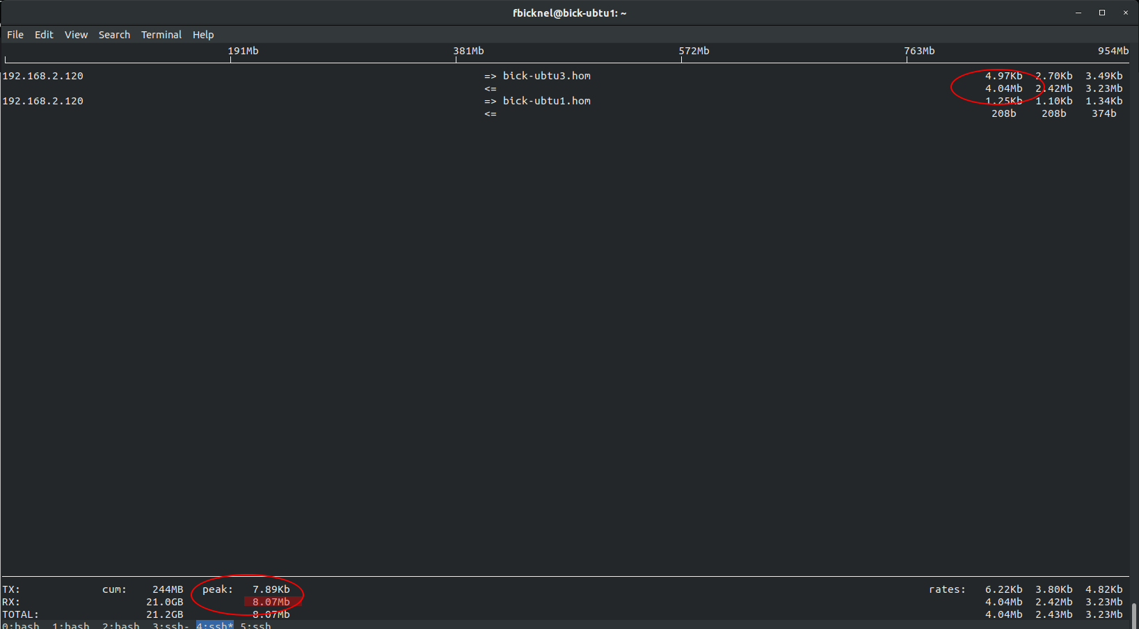

    I took a few screenshots of an HD movie, a UHD movie, and iperf running. Here they are:
    So I don't think there's a network issue.

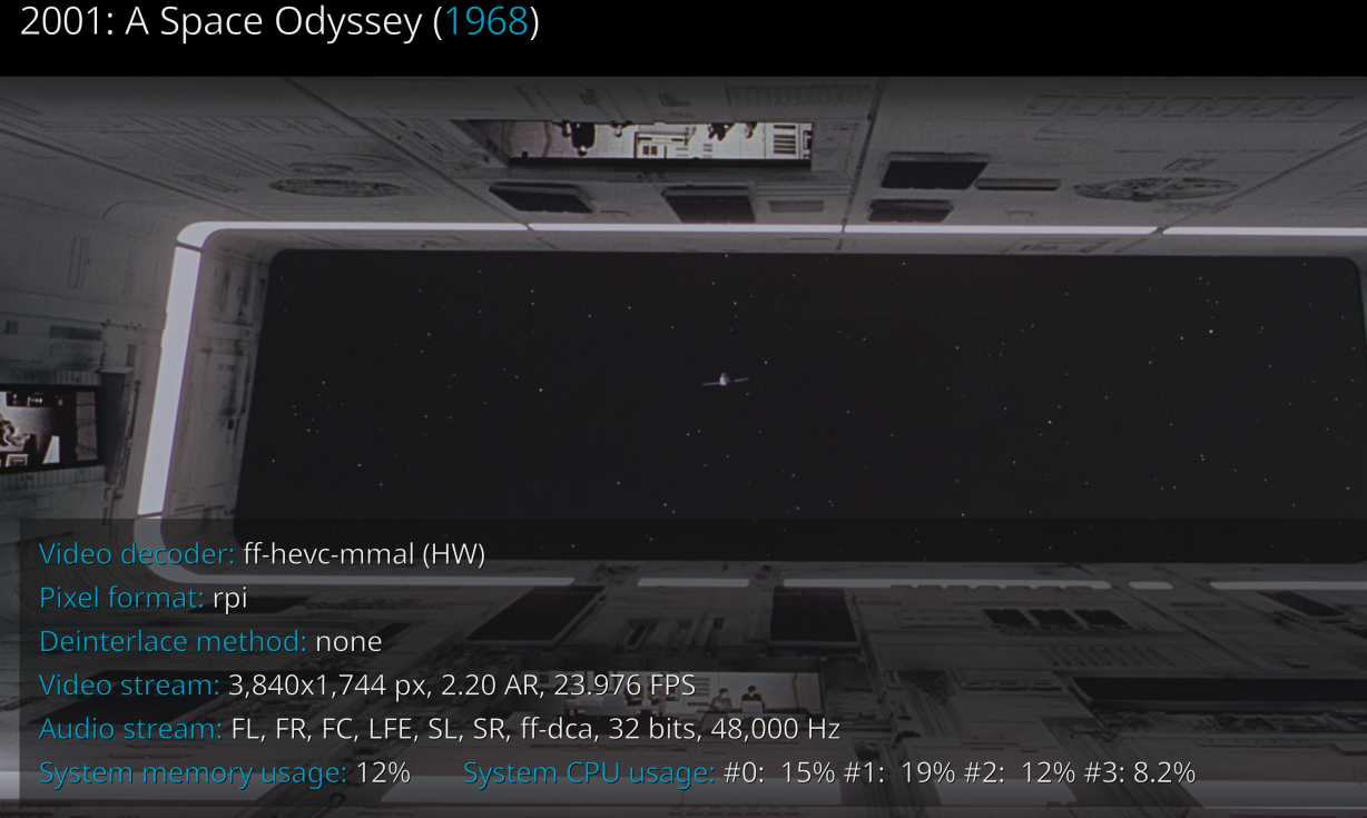

    One more bit of data: the onscreen player process info (key 'O') shows this:
    Video decoder: ff-hevc-mmal (HW)
    Pixel format: rpi
    Deinterlace method: none
    Video stream: 3,840x2,160 px1.78 AR, 23.976 FPS
    Audio stream: FL, FR, FC, LFE, SL, SR, ff-eac3, 32 bits, 48,000 Hz
    System memory usage: 12% (stable) System CPU usage; (all over the place as usual, bbut max seems to be 37% for brief moments, dodging from one cpu to the other... lows in the single digits, most teens to 20's. I know. Not terribly [word meaning science in the adjectival form]. :) )
    top shows the load average to be 1.33, 1.00, 0.9 as the movie runs. That's a little more [word meaning science in the adjectival form].
