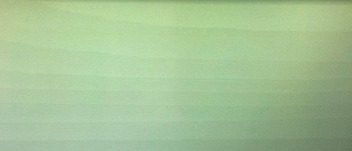

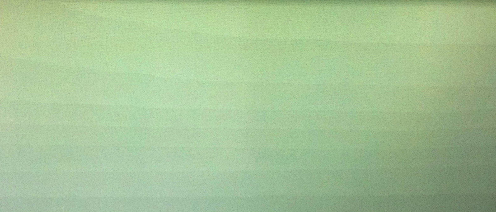

    4k HDR with Atmos - video gets hickups from time to time a small ones like a frame or two is missing. Still clouds problems looks like layers. Sound is great, no hickups, no problems.
    I'm attaching the shot of the clouds issue not sure however if this problem should be mentioned in this thread however. The colors are of course invalid, but I had to play with it a bit so the problem would be easily visible.
