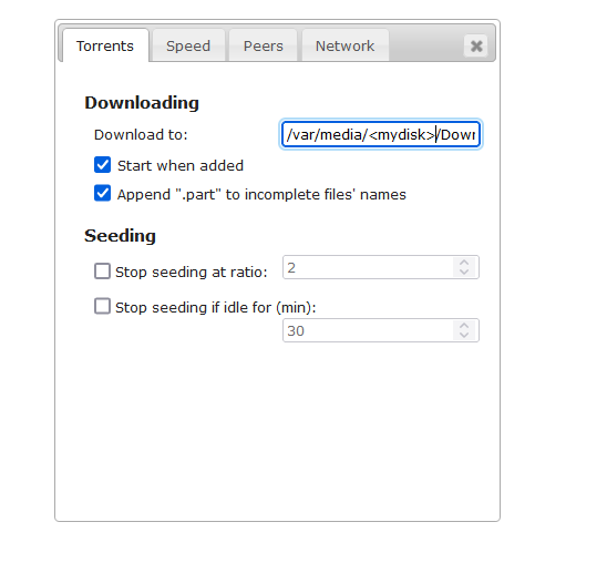

    But I try to change destination of my Complete and incomplete files... but don't work with Transmission Web interface Setting.
    Can I change default directory /storage/.config/dockers/transmission/downloads with my external usb hard-disk?
    Ok I understand.. /downloads (in download to) is directory during installation with docker... "-v /var/media/<my_hdd>/downloads = /downloads in webui configuration.
    But I want change the old configuration during first installation... What are the corrects command in Putty to reinstall Transmission Docker or to reconfingure it?
    NEW --> I solved!!!
    1 - docker stop 9091-transmission
    2 - docker rm 9091-transmission
    3 - docker run.... (same options) I change :/download \ with my external /var/media/<myhdd>/downloads disk directory!!!
    Now its work!!!
    Thanks!

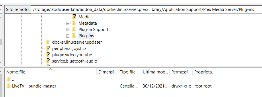

    I try to unzip plugin in this directory:
    /storage/.kodi/userdata/addon_data/http://docker.linuxserver.plex/Library/Application Support/Plex Media Server/Plug-ins

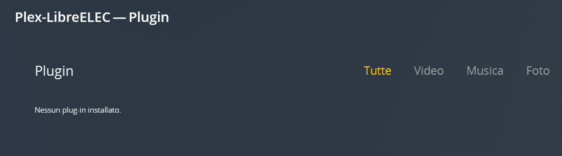

    Reboot Plex Media Server but in Plugin list:
    Plex media server on Libreleb docker support the plug-ins?
    It's a correct ftp directory to install plug-ins?
    Thanks at all!
    [SOLVED] - rename directory without "-master"...
