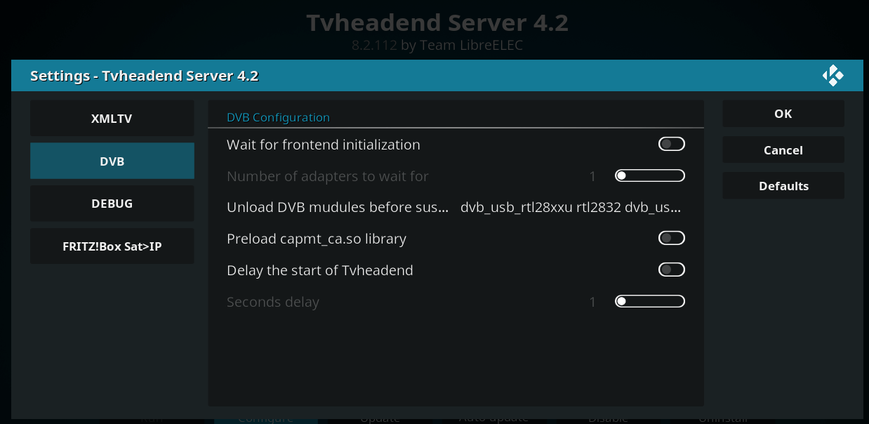

    Hello,
    I'm using a Raspberry Pi 3, with LE LibreELEC-RPi2.arm-9.2.0.img. I have setup TVheadend.
    When I reboot the PI, both Kodi & tvheadend web ui don't list my recordings anymore. However, they are physically still stored on a 2TB USB external hard drive (/var/media/RED_2TB).
    I think this relates to the tread: TVheadend problems after new update - lose list of recordings - Raspberry Pi - OSMC Forums
    Is there a way to delay TVH when starting up?
    FYI, my dmesg log is here: http://ix.io/27YL
    Thanks!
